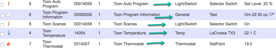

Hello TerrorSource,
I have running Toon in Domoticz and I can use:
Toon Program Information
Toon Auto Program
Toon Scenes
Toon Temperature
Toon Thermostat
Now also installed apple homekit on my raspberry PI1 and connect in to Domoticz.
When I open my Iphone or Ipad I see he makes 2 light swith in homekit: Toon Auto Program and Toon Scenes ( but these are in domoticz push buttons ) and on the apple I can only slight.
I do not see Toon Temperature and Toon Thermostat when I say hey siri what is the temperature it says no device found.
Could you give me a small wiki how I connect the TOON in domoticz works but how from DOMOTICZ to apple homekit.
Thanks for your help.

Hello TerrorSource,
Toon Auto Program
Toon Scenes
Toon Temperature
Toon Thermostat
@TerrorSource
Hello,
I could not find that part
the only thing what I did is: edit the config.json file
I Domoticz self I create a room the room has IDX2 so I add it as roomid2 plus I putt all my devices in that room.
But for my under standing, I need to edit config.json and putt there Toon Program Information with idx number and than Toon Auto Program with idx number - Toon Scenes Toon Temperature -Toon Thermostat etc.
In domoticz self everything works, it is only for in the homekit from apple and siri.
This how I install the connection to the Toon where you see the arrows that is type that I choose.
Hello,
"bridge": {
"name": "Homebridge",
"username": "CC:22:3D:E3:CE:30",
"port": 51826,
"pin": "031-45-154"
"description": "This is an example configuration file with one fake accessory and one fake platform. You can use this as a template for creating your own configuration file containing devices you actually own.",
"accessories": [
"platforms": [
"platform" : "Domoticz",
"name" : "Domoticz",
"server" : "127.0.0.1",
"port" : "8080",
"roomid" : 2,
"loadscenes" : 0
- type.jpg (158.98 KiB) Viewed 14821 times
