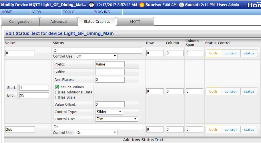

I'm brand new to HomeSeer and am just using it to connect my Zwave devices to Node-Red. For the control side I've just been setting up virtual devices with the same Status Values as my physical devices and then linking the virtual device to the physical device. That seems a lot simpler to me than setting up a bunch of one off events.

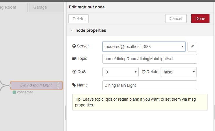

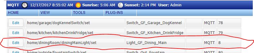

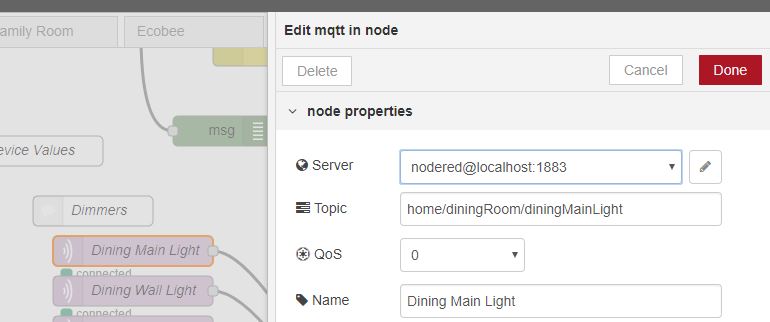

How I have mine setup is I use two flavors of mqtt topics for each device (home/[room]/[device] for status from HomeSeer and home/[room]/[device]/set to send commands to HomeSeer. So for example in HomeSeer I have my Dining Room Main Light set up to publish it's status to mqtt: Then in Node-Red I bring that in through an mqtt-In node: Then in Node-Red when I have a rule set to act on the light I publish that back through my /set topic using an mqtt-out node: In HomeSeer I subscribe to the /set mqtt topic: And assign that to a virtual device which I link back to my physical device (I did have to update to the most recent version of HomeSeer to get this option): And setup the status options to mirror the physical device (not sure this is 100% necessary but if I remember right it didn't work until I did): Let me know if that helps or any other information I can provide.

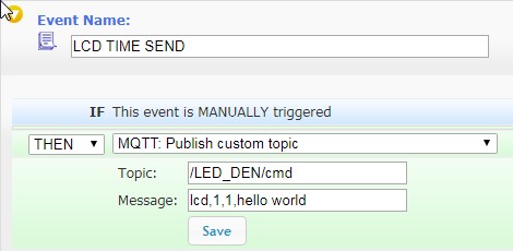

Am I doing something wrong?
Trying to send an MQTT command to an ESP Easy LCD display.
The attached picture works fine - the LCD updates.
But I need to transfer this ability to a script - so I did this: &hs.PluginFunction("MQTT", "", "publish", {"/LED_DEN/cmd", "lcd,1,1,hello world"})
I get this: Running script(2) &hs.PluginFunction("MQTT", "", "publish", {"/LED_DEN/cmd", "lcd,1,1,hello world"}), init error: Invalid character
I am basing that script off of the MQTT Plugin description: Example: hs.PluginFunction("MQTT", "", "publish", {"/tmp/myTopic", "1234"})

change &hs to &nhs and it should work.
In a script you can use:
Regards,
Geert-Jan
&nhs.PluginFunction("MQTT", "", "publish", {"/LED_DEN/cmd", "lcd,1,1,hello world"})
dim result as object
result=hs.PluginFunction("MQTT", "", "publish", {"/LED_DEN/cmd", "lcd,1,1,hello world"})

Is there anyway to delete mqtt subscription entries? I had a typo in one and it seems to be conflicting with the replacement I put in place even though I deleted the device.
Re: HS3 MQTT Plugin
Deleting the device should be sufficient. If you stop and start the plugin the list of subscriptions is rebuild, maybe that can help.

My first one was "home/masterBathroom/southSInkLight/set" (with the capital I). When I tried it as "home/masterBathroom/southSinkLight/set" the next time it assigned it to that same device and seemed to put a tab in front of it that showed up as a bunch of spaces in the data field and the virtual device wasn't picking up the topic. So I deleted that device and tried a third time and it got the address right but the virtual device wasn't picking up the commands.
