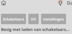

Hello,
I install this app on my Toon, I also installed Dashticz on my Raspberry PI.
I see my light swith on Dashticz plus in my Domoticz that works okay.
But I can not see the light buttons on my Toon.
On my Toon
dashticz toon.jpg (57.24 KiB) Viewed 14762 times
What is IDX? how could I see this on my Raspberry PI maybe that is the issue I could not find it on Dashticz.
Here you see it is searching for the light buttons.
search for light.jpg (15.04 KiB) Viewed 14762 times

Hi michel30.
I managed to get my lights in to first setup the file "dashticz.settings" before rebooting the gui with killall qt-gui:
If you don't use authentication leave the password and username empty like this:
{"domoticzHost":"<your ip>","domoticzPassword":"","domoticzPort":"<your port>","domoticzUsername":""}
Grz.
Hubble
michel30
Posts: 292
Re: Toon app: Dashticz (for Toon); NEW: OV Info (NL)
Post by michel30 »
That is funny, I did this many times, but I see you using it in a different way and that works :-) super thanks for you info.
