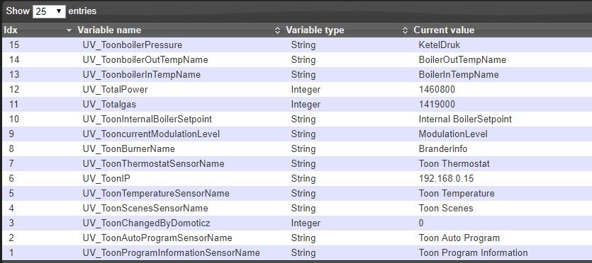

Hypermobile wrote:Adjusted somebody elses Script to get it to work with this new app:
It's for Domoticz:
1) make 5 UV_variables in domoticz
UV_ToonIP => {STRING} =192.168.x.x
UV_DomoticzIP => {STRING} = 192.168.x.x
UV_ToonboilerInTempName => {STRING} = BoilerInletTemp
UV_ToonboilerOutTempName => {STRING} = BoilerOutletTemp
UV_BoilerPressure => {STRINT} = BoilerPressure
2) Create 3 dummy sensor; with Name BoilerInletTemp, BoilerOutletTemp, BoilerPressure
3) Create a LUA TIME Event copy paste script.
It's for Domoticz:

I also implemented this script in Domoticz but in the log it shows an error:
EventSystem: in toon_boiler: [string "-- Time script runs every minute, intended to..."]:31: attempt to perform arithmetic on field '?' (a nil value)
Does anone know how to correct this or give me a hint what I did wrong?

This is my LUA TIME EVENT:
You Need to create a WHole Bunch of USER Variables. to get it to work
-- Time script runs every minute, intended to sync Domoticz with Toon in case the value is changed on the physical device.
-- Updates Toon Thermostat Sensor to value set on Toon

    CurrentToonAutoProgramSensorValue = otherdevices_svalues[ToonAutoProgramSensorName]
    if currentProgramState == 0 then currentProgramState = '10' -- No
    elseif currentProgramState == 1 then currentProgramState = '20' -- Yes
    elseif currentProgramState == 2 then currentProgramState = '30' -- Temporary
    end
    if CurrentToonAutoProgramSensorValue ~= currentProgramState then -- Update toon auto program selector if it has changed
        print ('Updating Toon Auto Program selector')
        commandArray[5] = {['UpdateDevice'] = string.format('%s|1|%s', otherdevices_idx[ToonAutoProgramSensorName], currentProgramState)}
    end
    -- Updates the toon program information text box
    CurrentToomProgramInformationSensorValue = otherdevices_svalues[ToonProgramInformationSensorName]
    if currentNextTime == 0 or currentNextSetPoint == 0 then
        ToonProgramInformationSensorValue = 'Op ' ..currentSetpoint.. '°'
    else
        ToonProgramInformationSensorValue = 'Om ' ..os.date('%H:%M', currentNextTime).. ' op ' ..currentNextSetPoint.. '°'
    end
    if CurrentToomProgramInformationSensorValue ~= ToonProgramInformationSensorValue then
        commandArray[6] = {['UpdateDevice'] = string.format('%s|0|%s', otherdevices_idx[ToonProgramInformationSensorName], ToonProgramInformationSensorValue)}
    end
 -- Update the toon burner selector to current program state
    CurrentToonBurnerValue = otherdevices_svalues[ToonBurnerName]
	if currentBurnerInfo == 0 then currentBurnerInfo = '0' -- uit
    elseif currentBurnerInfo == 1 then currentBurnerInfo = '10' -- cv aan
    elseif currentBurnerInfo == 2 then currentBurnerInfo = '20' -- warmwater aan
    end
    if CurrentToonBurnerValue ~= currentBurnerInfo then  -- Update toon burner selector if it has changed
        print ('Updating Toon burner info')
        commandArray[7] = {['UpdateDevice'] = string.format('%s|1|%s', otherdevices_idx[ToonBurnerName], currentBurnerInfo)}
    end
 -- Update the modulation level of the burner
    if otherdevices_svalues[TooncurrentModulationLevel]+1 ~= currentModulationLevel+1 then
        print('Updating the ModulationLevel to new value: ' ..currentModulationLevel)
        commandArray[8] = {['UpdateDevice'] = string.format('%s|0|%s', otherdevices_idx[TooncurrentModulationLevel], currentModulationLevel)}
    end
      -- Update the Internal Setpoint of the boiler
    if otherdevices_svalues[ToonInternalBoilerSetpoint]+1 ~= currentInternalBoilerSetpoint+1 then
        print('Updating the currentInternalBoilerSetpoint to new value: ' ..currentInternalBoilerSetpoint)
        commandArray[9] = {['UpdateDevice'] = string.format('%s|0|%s', otherdevices_idx[ToonInternalBoilerSetpoint], currentInternalBoilerSetpoint)}
    end
else
print ('Geen data terug')
end
return commandArray
