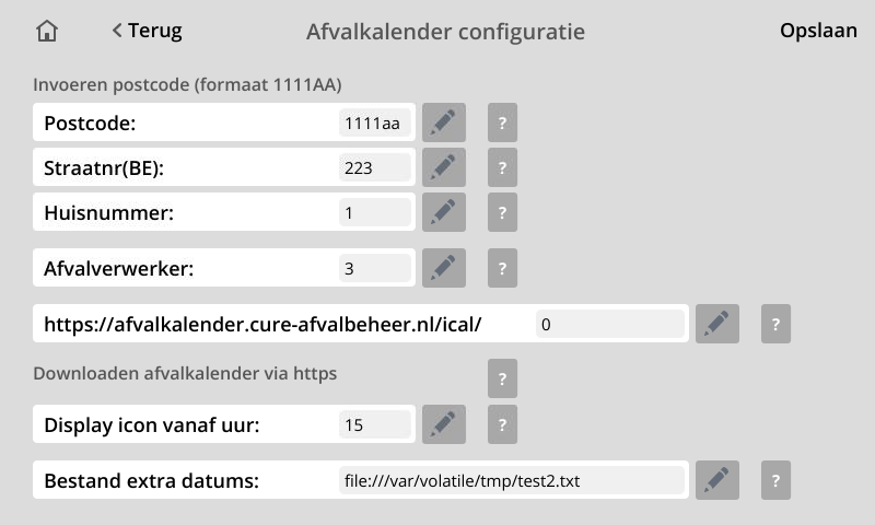

Small progress update:
I have this working now for the dates and existing waste types. You can configure the URL or local file name for the file with the additional dates.
I will also give the option to add a custom category so you can use your own icon for that category.
This is also a convenient solution for everyone without an interface to their waste provider, you can create your own waste calendar this way and maintain it outside Toon.
Needs some work before it can be released but just thowing it out here for feedback.
New settings screen:
