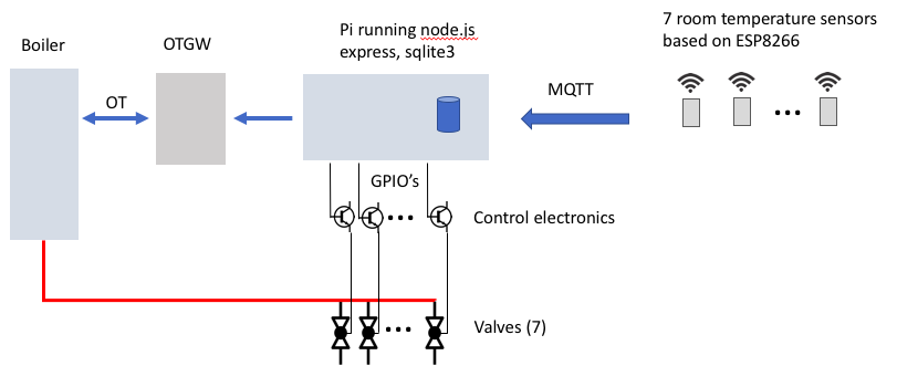

OK thanks, I reckon it can be done, yet not sure how. I've added a drawing reflecting my setup.
Sensors reports plain temperature. The code in the Pi checks with desired value in the database and if needed opens the valve to the room and starts the boiler.
I understand that I need to write my own code, question would be if I should use the gateway to start the boiler or would it be better/advisable to leave out the otgw and directly communicate with the boiler?
Or is the code that I need to write exactly the same in both cases and it the gateway 'only' for reporting/graphs?
For me, it is not yet clear how to tackle this. Any advise is very much appreciated!
Frank
Frank

I think you are a bit confused about the terminology. The OTGW is the hardware interface that will allow your Pi to talk to the boiler. It's basically an Opentherm <-> RS232 converter (with a few extra features). You will need that, unless you have some other way to talk to the boiler. The part that does the reporting/graphs is OTmonitor. That just a piece of software. In your case I definitely wouldn't put that in between. It only adds more possibilities for failure.
It might be useful for your program to provide a server socket that echoes the communication with the OTGW. Then you can connect OTmonitor to that when you want to do some debugging.

The on/off control of the gateway is very simplistic. Since the gateway doesn't know the room temperature when used this way, it can not determine how much heat is needed, so it just turns the boiler on at full blast. But as I understand it, that is no worse than what your current control is doing.
I think the next step would be to tell the gateway the water temperature you want the boiler to produce. So, probably on a regular basis, you calculate that value and send a CS command to the gateway. If you only need a little bit of heating when one room is falling below the setpoint, that would be a low value, 35⁰C or so. If you want to increase the temperature by several degrees in multiple rooms, it could be 80⁰ or even more. If no heating is required, you send CS=0. That will also switch off the CH enable bit, which will usually cause the pump to stop running after a while in most systems.
For even more control, you can also use the MM command. But I have only ever seen 2 values from existing thermostats: 0% and 100%. 0% means minimal heating (but heating nonetheless). This may seem strange at first glance, but the MM command applies to the parameter called "Maximum Relative Modulation". It specifies a point between the minimum and maximum modulation a boiler can do. A relative value of 0% may translate to something like 30% absolute modulation. Generally speaking you would normally set either MM or CS to its maximum value and then control the temperature with the other parameter. You can switch between the two methods depending on the circumstances.
Using the method described above, the gateway will send OT messages to the boiler every second, as prescribed by the specs. Your program only has to send a CS command whenever a new value has been calculated. Every 30 seconds would be frequently enough. It doesn't even have to be on a regular basis.
It is possible for your Pi to be in complete control of the OT messages that are sent to the boiler. But then you need to load different firmware: interface.hex. I would not advise to do that unless you run into limitations with the CS command.
Now the difficult part is calculating the desired water temperature. With one input (thermostat) that's already complicated enough (suggested search term: PID controller). I really have no idea how to do it with 7, especially if each room can have a different setpoint. Maybe just calculate a desired water temperature for each room and let the highest one win. But the number of open valves will probably also affect the heating characteristics. I'm afraid I can't be of much help there.

The data format you describe is what is used on the Opentherm interface between the OTGW and the boiler. Between the Pi and the OTGW, communication happens on a higher level. So an example of the CS command your program would send to the OTGW is: CS=32.48\r (where \r is the carriage return character). That will lead to the OTGW sending the Opentherm message 0x1001207A to the boiler or, in binary: 0 001 0000 00000001 00100000 01111010. But you don't have to worry about that.

Unless you use the wifi version of the OTGW, the communication between the Pi (or other computer) and the OTGW is via a serial device, either a real serial port or a USB-serial adapter. The serial interface uses 8-bit data words with no parity and 1 stop bit at 9600 baud. This information is actually mentioned on the web site.
Now, how to do serial communication using node/c, I can't tell you. I don't even know what node/c is, unless you mean node.js or C. In C it is quite a bit of work. In Tcl it is simple, which is why I used Tcl for OTmonitor
