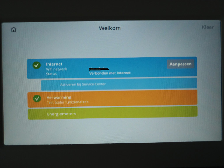

ok couldn`t resist ,part because somethings didn`t work correctly yet so i used youre 2.0 to upgrade from 4.11 to 4.12

I am using the upgrade scrip 2.0 on my TOON I see REBOOTING with circle and my log file is stopped here:
/tmp/update.status.vars: Installing 96% (168/171) hcb-config
Upgrading hcb-watchdog on root from 1.69-master to 1.71-master...
Copying /mnt/data/update/hcb-watchdog_1.71-master_qb2.ipk.
update-rc.d: /etc/init.d/samba exists during rc.d purge (continuing)
 Removing any system startup links for samba ...
Updating certificates in /etc/ssl/certs...
1 added, 0 removed; done.
Running hooks in /etc/ca-certificates/update.d...
done.
0 added, 0 removed; done.

Thanks for the reply, after the upgrade to 4.13.7 I seem to be a bit stuck in the 'installatie wizard' I have only the temp and +/0 buttons active, and need to add functionality by running it.
But I only see this, no idea how to select energiemeters or overrule the wizard to get the normal screen again with the basic toon features?
Regards, Ron.
