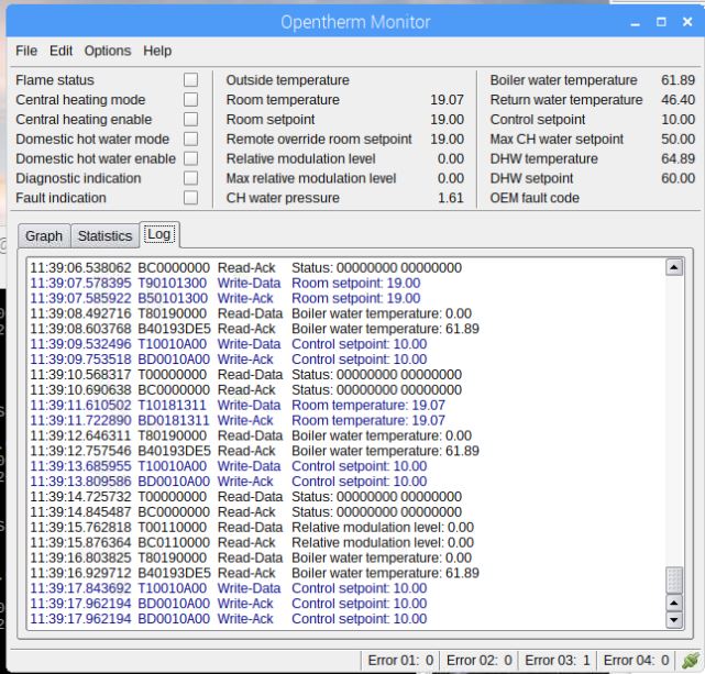

Unfortunately, my OTG has the same problem:
14:45:57.278123  BE0800000  Data-Inv    Message ID 128: 0
14:45:57.948281  T90822B41  Write-Data  Message ID 130: 11073
14:45:58.265103  B50822B41  Write-Ack   Message ID 130: 11073
14:45:58.938299  T00300000  Read-Data   DHW setpoint boundaries: 0 0
14:45:59.253963  BC030410A  Read-Ack    DHW setpoint boundaries: 65 10
14:45:59.925079  T80000200  Read-Data   Status: 00000010 00000000
14:46:00.247648  B40000200  Read-Ack    Status: 00000010 00000000
14:46:00.915342  T10010A00  Write-Data  Control setpoint: 10.00
14:46:01.148033  800000
14:46:01.159393  0800000
14:46:01.167420  0822B41
14:46:01.174990  0822B41
14:46:01.186770  0300000
14:46:01.194276  030410A
14:46:01.201898  0000200
14:46:01.213904  0000200
14:46:01.223649  0010A00
14:46:01.286453  800OpenTherm Gateway 4.2.5
14:46:01.298781  WDT reset!

Unfortunately, OTG frozen again. It does not respond Reset command.
Is there any way how to trace the bug now or should I just perform HW reset and go on?
08:04:54.689785  T10181644  Write-Data  Room temperature: 22.27
08:04:54.958446  BD0181644  Write-Ack   Room temperature: 22.27
08:04:55.678303  T80800000  Read-Data   Message ID 128: 0
08:04:55.948332  BE0800000  Data-Inv    Message ID 128: 0
08:04:56.668036  T90825341  Write-Data  Message ID 130: 21313
08:04:56.936557  B50825341  Write-Ack   Message ID 130: 21313
08:04:57.657660  T907E0101  Write-Data  Master product version: 1 1
08:04:58.123783  B507E0101  Write-Ack   Master product version: 1 1
08:04:58.643774  T00000000  Read-Data   Status: 00000000 00000000
08:04:58.916142  BC0000000  Read-Ack    Status: 00000000 00000000
08:04:59.637445  T10010A00  Write-Data  Control setpoint: 10.00
08:04:59.904641  BD0010A00  Write-Ack   Control setpoint: 10.00
08:05:00.675800  T10080A00  Write-Data  Control setpoint 2: 10.00
09:19:01.044030  Command (via websocket from 192.168.123.1:48465): GW=R
