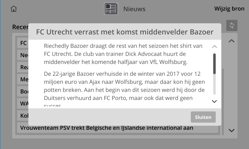

I just published the initial release of the newsreader app which can show actual rss feeds.
News items are refreshed every 10 minutes.
An initial set of rss sources has been included (/qmf/qml/apps/newsreader/userSettings.json).
This list can be edited via the app or via ssh (gui restart required after editing via ssh).
The default list is attached here in a zip file for reference:
userSettings.zip
(448 Bytes) Downloaded 847 times

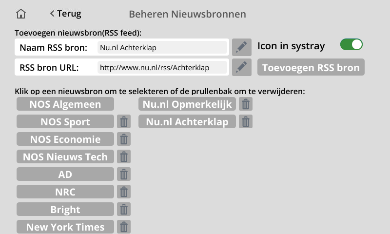

The app also installs full list of CA root certificates for use in https connections (source: actual Mozilla CA root certificate store).
Via the menu option 'Wijzig bron' you can select another defined rss source to show, delete existing ones or add new ones.
The tray icon can be disabled.
The tile always shows the latest News header from the current selected rss feed.
Known limitations in the initial release:
- images included in the rss feed are not shown
- if links are provided to websites they will not work obviously as Toon doesn't have a browser
Have fun and let the change requests and bug reports coming..... :-)

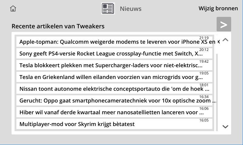

Posts: 1918
Re: Toon app: Newsreader (RSS)
mAiden wrote:Only do not work Tweakers' RSS feed, as it works with feedburner ( http://feeds.feedburner.com/tweakers/mixed )
The tweakers link works fine on my Toon 1 (fw4) and Toon 2 (fw5).
Have you entered the link in the userSettings.json file as "Tweakers@http://feeds.feedburner.com/tweakers/mixed" ?
The text "Tweakers" before the @ is just a logical name of the URL to be shown in the settings screen

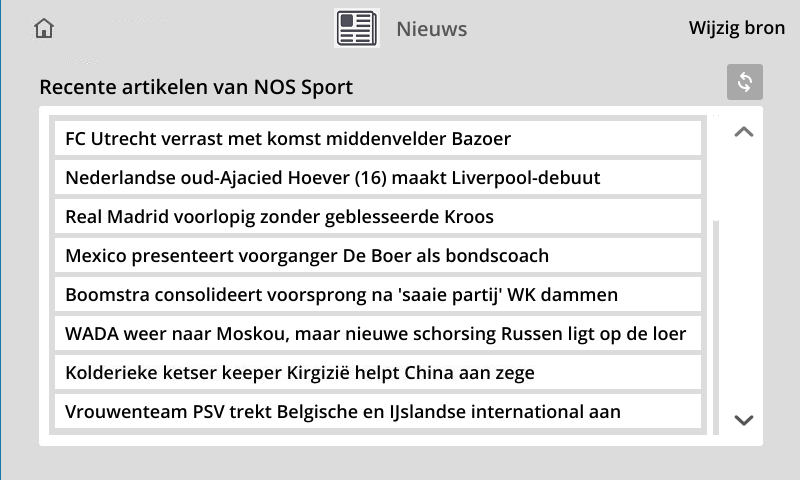

the next major version of the newsreader app will be available in the ToonStore early next week (need to do more testing on different firmwares and Toon 1 /2).
Preliminary Changelog 1.1.0:
- all rss feed text now shown as rich text on the tile and screens
- item detail screen completely redesigned, is now a 'flickable' full screen text area
no scrollbar anymore, scroll via vertical swipe gestures
- now showing the publishing time of each item on all screens
- overview screen is now more responsive to clicks (whole cell is clickable compared to the textfield only previously)
- in the overview screen you can now scroll between the different RSS feeds
- in the News item detail screen you can scroll back and forth through the News items of that rss feed
Kind regardz,

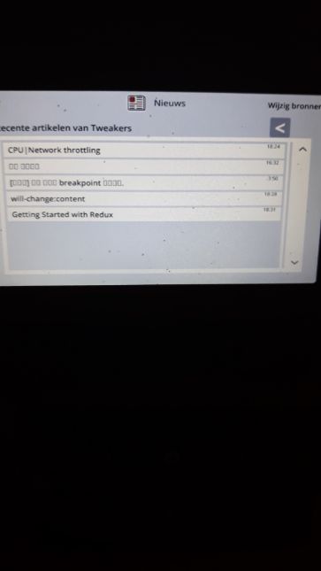

Strange Toonz. This is what i get when i put the url in it.
Add url and name to the app from the config screen.
Posts: 1918
wow, weird. Did you install the app via ToonStore?
My userSettings.json for newsreader 1.1.0:
{"Newsfeeds":["Tweakers@http://feeds.feedburner.com/tweakers/mixed","NOS Algemeen@http://feeds.nos.nl/nosnieuwsalgemeen","NOS Sport@http://feeds.nos.nl/nossportalgemeen","NOS Economie@http://feeds.nos.nl/nosnieuwseconomie","NOS Nieuws Tech@http://feeds.nos.nl/nosnieuwstech","AD@http://www.ad.nl/rss.xml","NRC@http://www.nrc.nl/rss","Bright@http://feeds.bright.nl/brightmagazine?format=xml","New York Times@http://rss.nytimes.com/services/xml/rss/nyt/HomePage.xml","Nu.nl Opmerkelijk@http://www.nu.nl/rss/Opmerkelijk","Nu.nl Algemeen@http://www.nu.nl/rss/Algemeen","Nu.nl Wetenschap@http://www.nu.nl/rss/Wetenschap"],"TrayIcon":"Yes","LastUsedSourceIndex":0}
and the result (both on a Toon 1(fw4) and a Toon 2 (fw5)):
