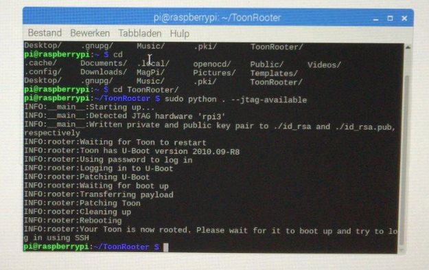

Started with some homeautomations recently and wanted to use the information Toon suplies too. So read about rooting the Toon and about this automated root script. I'm using a Raspberry PI 3 (B+) with clean install of Raspbian/NOOBS. Downloaded the rootscript as described and followed the manual. All looks good to me, but I'm not able to connect into Toon through SSH. When running the script with --output-level DEBUG I'm finding some /bin/sh: can't access tty; job control turned off messages. Perhaps this is some lead for someone?
Hope someone can help :-)
TerrorSource
Posts: 494
Re: Fully automated rooting script
Post by TerrorSource »
rotzen wrote:Hi all,
TheHogNL and me already tried to look into this but no solution or cause was found.
It looks like something in the the patch script is causing this, it does create a random password but it does not set it in passwd. all steps later in the script will not be executed somehow.
You try rooting again or try it on a later moment. Trying it on a later moment fixed it for me. I know, not a real solution :D
