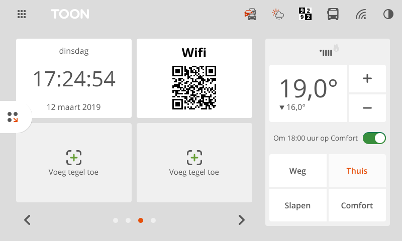

Nice idea! I just made a simple app that will show such a QR code on a tile. Unpack it in /HCBv2/qml/apps and store your QR image as /HCBv2/qml/images/wifi.png.
I created the QR image on a linux machine with the qrencode command, using the default of 3 pixels per dot.
This app assumes firmware 5.0.4 or higher and the tile is not expected to be on the main screen, so it doesn't deal with dim state.
Edit: Updated version. This now creates the QR code on the fly from the wifi configuration stored on the Toon.

Yes, that works! Very nice. (Although I still would like to learn how to use methods from a js file).
Now on to extract the wifi data from /HCBv2/config/config_hcb_netcon.xml ...
Posts: 2030
Re: Wifi QR code app
I have updated the zip file on the 2nd post in this topic. The new version now creates the QR code on the fly from the wifi configuration stored on the Toon.
