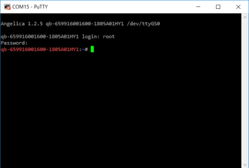

For the owner of a rooted Toon 2 you can now connect to a serial port on the Toon 2. However it is a simulated serial port over the USB connection. The only reason I can think of to use this is to test some wifi functions. But then again, maybe there are other reasons.

#connect your pc via a normal USB cable to the toon (you need a USB-A to USB-A, or if you have a USB-C port on your computer you could use a USB-A to USB-C)
#start getty manually:
su root -c "/sbin/getty 38400 ttyGS0" &
#connect to the toon2 with putty on the com-port which your computer created and use baud 38400
This is not boot-proof. To make it boot proof you need to make some boot scripts. However it is only working after this script, so during boot this USB serial port is useless.
Proof:
