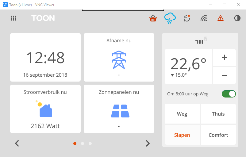

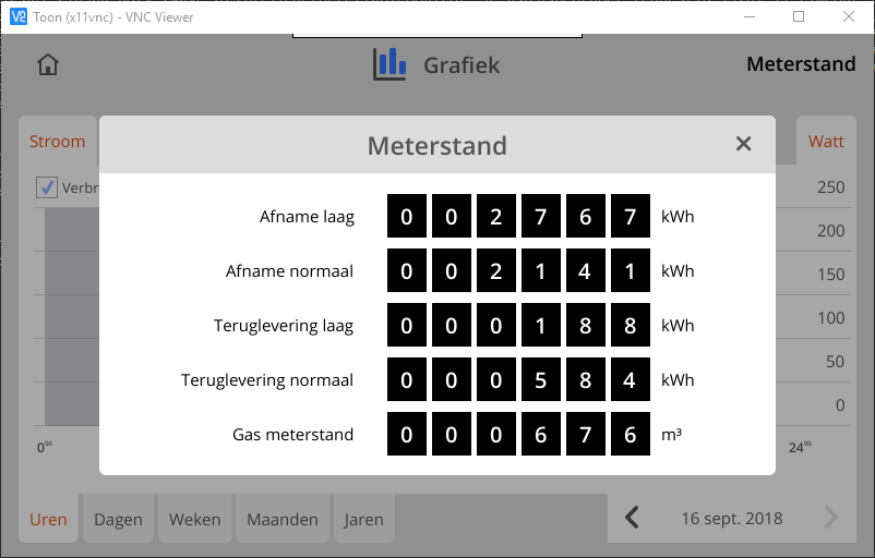

I don't think I need to say anything!
The gas usage however, is from the previous owner. How do I remove that from the readouts?
Also the current usage is not working as expected yet.
EDIT: the smart meter readout was stopped without me noticing it. It sent the retained MQTT message to the Toon, which was good, but not up to date.
I restarted the readout and the current usage popped up!
SUCCESS 2.png (39.75 KiB) Viewed 15893 times
