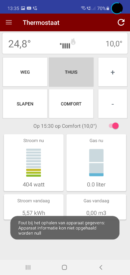

As mentioned in the Google play store, I get this error message.
RoadXY
Posts: 111
Joined: Wed Oct 21, 2015 8:11 am
Re: Toon for Android
Post by RoadXY »
Jasper wrote:As mentioned in the Google play store, I get this error message.
Which version of the app do you have?
You can check that in the settings of the app or by opening the drawer on the left.
Could you past the outcome of http://[IP-ADDRES-OF-TOON]/hdrv_zwave?action=getDevices.json
Jasper
Posts: 89
Joined: Wed Jun 05, 2019 11:29 pm
Post by Jasper »
Version 0.5.10
{"dev_settings_device": {"uuid": "d213df3c-c5dd-4e68-99b7-9128eb1648f8", "name": "settings_device", "internalAddress": "settings_device", "type": "settings_device"}, "dev_14": {"uuid": "e13a535e-ddc7-4739-ac04-f098bad85366", "name": "Lampjes", "internalAddress": "14", "type": "EM6550_v1", "supportsCrc": "0", "ccList": "25 27 72 86 75 73", "supportedCC": "25 27 72 86 75 73", "nodeFlags": [], "TargetStatus": "-1", "CurrentState": "-1", "IsConnected": "0", "HealthValue": "1", "DeviceName": "Lampjes"}, "dev_17": {"uuid": "ccd6f8f3-5770-4b94-804d-ed30b97b1a91", "name": "HAE_METER_v3", "internalAddress": "17", "type": "HAE_METER_v3", "supportsCrc": "1", "ccList": "5e 86 72 32 56 5a 59 85 73 7a 60 8e 22 70 8b 3c 3d 3e", "supportedCC": "5e 86 72 32 56 5a 59 85 73 7a 60 8e 22 70 8b 3c 3d 3e", "nodeFlags": [], "IsConnected": "1", "DeviceName": "HAE_METER_v3", "HealthValue": "10", "CurrentSensorStatus": "UNKNOWN"}, "dev_17.1": {"uuid": "8ca51e51-4e8b-4fe1-b68b-34767b51c704", "name": "HAE_METER_v3_1", "internalAddress": "17.1", "type": "gas", "supportsCrc": "0", "nodeFlags": [], "CurrentGasFlow": "182.00", "CurrentGasQuantity": "4200174.00", "DeviceName": "HAE_METER_v3_1"}, "dev_17.2": {"uuid": "3c460ec3-833a-4f94-9818-133a05633dbf", "name": "HAE_METER_v3_2", "internalAddress": "17.2", "type": "elec", "supportsCrc": "0", "nodeFlags": [], "CurrentElectricityFlow": "NaN", "CurrentElectricityQuantity": "NaN", "DeviceName": "HAE_METER_v3_2"}, "dev_17.3": {"uuid": "2115f78e-0570-4577-9d37-61568641bf2e", "name": "HAE_METER_v3_3", "internalAddress": "17.3", "type": "elec_solar", "supportsCrc": "0", "nodeFlags": [], "CurrentElectricityFlow": "3797.00", "CurrentElectricityQuantity": "2457127.00", "DeviceName": "HAE_METER_v3_3"}, "dev_17.4": {"uuid": "a16b3a91-63e9-4ec2-929d-4e13a5aecd50", "name": "HAE_METER_v3_4", "internalAddress": "17.4", "type": "elec_delivered_nt", "supportsCrc": "0", "nodeFlags": [], "CurrentElectricityFlow": "0.00", "CurrentElectricityQuantity": "6949199.00", "DeviceName": "HAE_METER_v3_4"}, "dev_17.5": {"uuid": "70be0518-1e82-41a1-9df5-7afc0af4136b", "name": "HAE_METER_v3_5", "internalAddress": "17.5", "type": "elec_received_nt", "supportsCrc": "0", "nodeFlags": [], "CurrentElectricityFlow": "3316.00", "CurrentElectricityQuantity": "4672753.00", "DeviceName": "HAE_METER_v3_5"}, "dev_17.6": {"uuid": "fb56b156-3b42-45f5-a6b8-5fa8598662e0", "name": "HAE_METER_v3_6", "internalAddress": "17.6", "type": "elec_delivered_lt", "supportsCrc": "0", "nodeFlags": [], "CurrentElectricityFlow": "0.00", "CurrentElectricityQuantity": "7782300.00", "DeviceName": "HAE_METER_v3_6"}, "dev_17.7": {"uuid": "4d3da2f1-a06f-4768-9c0b-d52a1d2438e1", "name": "HAE_METER_v3_7", "internalAddress": "17.7", "type": "elec_received_lt", "supportsCrc": "0", "nodeFlags": [], "CurrentElectricityFlow": "0.00", "CurrentElectricityQuantity": "1961202.00", "DeviceName": "HAE_METER_v3_7"}, "dev_17.8": {"uuid": "4a9a478b-bee6-4bd9-b2c9-e8831ff3f78f", "name": "HAE_METER_v3_8", "internalAddress": "17.8", "type": "heat", "supportsCrc": "0", "nodeFlags": [], "CurrentHeatQuantity": "NaN", "DeviceName": "HAE_METER_v3_8"}, "dev_2": {"uuid": "8655ca7c-c82f-4d45-84a9-1e2f8b14c7e3", "name": "Hal", "internalAddress": "2", "type": "EM6550_v1", "supportsCrc": "0", "ccList": "25 27 72 86 75 73", "supportedCC": "25 27 72 86 75 73", "nodeFlags": [], "IsConnected": "1", "HealthValue": "10", "DeviceName": "Hal", "CurrentState": "0", "TargetStatus": "0"}}
RoadXY
Posts: 111
Post by RoadXY »
I'll add support for Toon Z-wave devices in 0.5.11
But holy sh*t, that's a lot of previously connected devices in Toon: 17!
