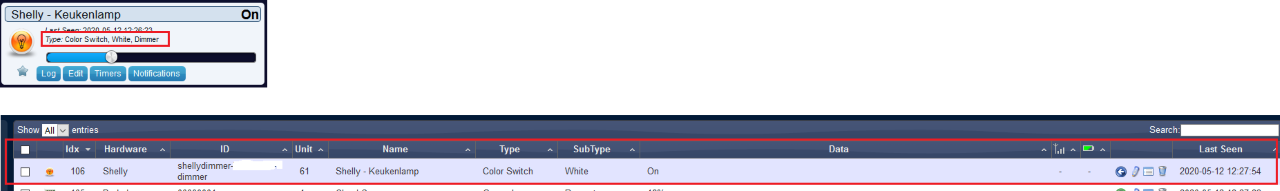

In Domoticz the Shelly Dimmer is auto discovered, I'm not able to change the type into Light:

can you send me a PM with the block for this dimmer from your json file (http://yourdomoticz_ip/json.htm?type=devices&filter=all&used=true&order=Name)?
Re: Toon app: DomoticzBoard
PM sent
PM returned with a possible solution (for testing)
. Let me know if this worked, I can include it in a next release.
Yes it Works great now, thanks for this quick solution!
