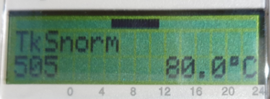

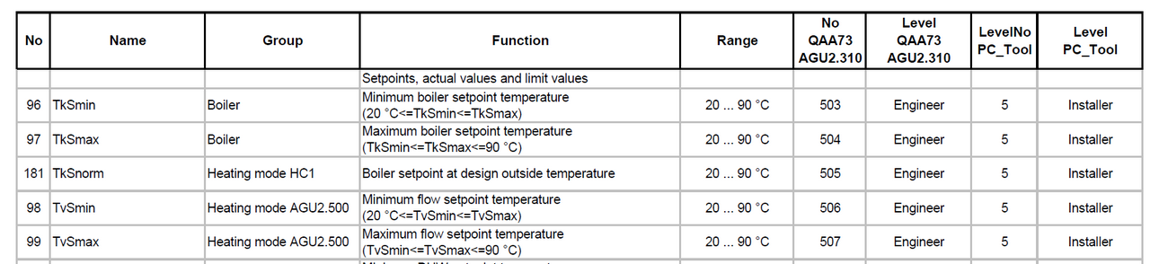

Hi Schelte,
I've found only logs from 2 days ago and if I understand correctly that Message ID = Max CH setpoint boundaries I see this:
If Max CH setpoint boundaries MsgID 49 is related to LMU64 values 505 and 506 then something is wrong with my boiler as I can see values 80 20, but in the otmonitor log there is value 89 20.
Maybe I'm looking into wrong values as in the LMU64 documentation there is another line (504 TkSmax Maximum boiler setpoint temperature) which is not visible through QAA73.
I will try to connect otgw between QAA73 and LMU64 and will have a look to line 506 if value 404.0 C is still there and then compare it with MsgID 49 values in the log.
P.S: Would it be possible to add MsgID info into the log in future relases of otmonitor? The same way as seen on your website e.g. Max CH setpoint boundaries (MsgID=49)

- LMU64 parameters
- LMU64.PNG (164.22 KiB) Viewed 6431 times
- 506_TvSmin.PNG (233.31 KiB) Viewed 6431 times
- 505_TkSnorm.PNG (245.69 KiB) Viewed 6431 times

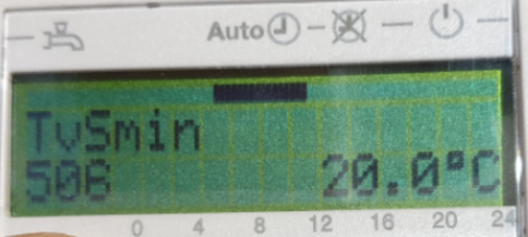

Re: QAA73.110 showing incorrect values when otgw connected
Just a quick update on this strange behavior - it looks to me that it's caused by OTGW setting GW=1 (gateway mode).
I've made several tests with 2 different OTGW devices and found line 506 TvSmin with incorrect value 404 C only when OTGW in gateway mode.
Switching back to GW=0 solved this issue.
I believe it's only cosmetic issue and undiscoverable in most cases as most users are not going to check regularly LMU values (which are accessible to OEM/serviceman) using QAA73...
And also value 404 C is out of allowed range for this variable.
GW=0 --> value 506 (TvSmin) is set to 20.0 C
GW=1 --> value 506 (TvSmin) is set to 404.0 C
Thank you for confirming this. I believe it's caused by setting QAA73 to "programming" mode and OTGW somehow interfering communication between QAA and LMU. It's only cosmetic defect found and does not affect boiler performance.fojtp wrote:GW=0 --> value 506 (TvSmin) is set to 20.0 C
