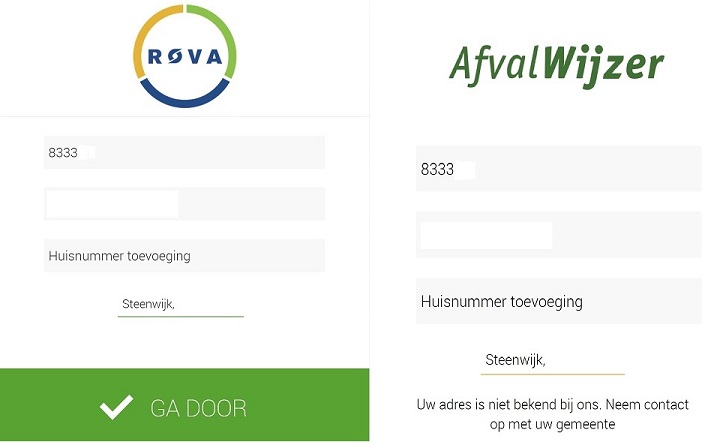

Sadly the afvalwijzer app doesn't work anymore on my Toon 2. My address is unknown on the site https://mijnafvalwijzer.nlrova.nl (old provider "14") is now using mijnafvalwijzer.nl (choose provider "1")
Looks like Steenwijkerland is not added to this site, tried different addresses to test it.
Only site that works for me is https://inzamelkalender.rova.nl/
Is it possible to add ROVA as a separate waste collector?
Keep up the good work!

Re: Toon app: Afvalwijzer
I will have a look what can be done for zipcode 8333
Stay tuned
Stay tuned

Hi,EchoNL wrote: Is it possible to add ROVA as a separate waste collector?
EchoNL
I just added rova.nl again, goto the settings screen and select provider 14 (rova.nl) and enter your zipcode/housenr.
I tested it succesfully with a random postcode/housenr combo in Steenwijk.
(P.S. Assuming you have the latest version of the app 5.1. If not, update first via the ToonStore.
P.P.S. you should be able to select '14', if you get the error message 'onbekende afvalverwerker' please restart the gui via the TSC menu to fix that and let me know here)
Kind regardz,
