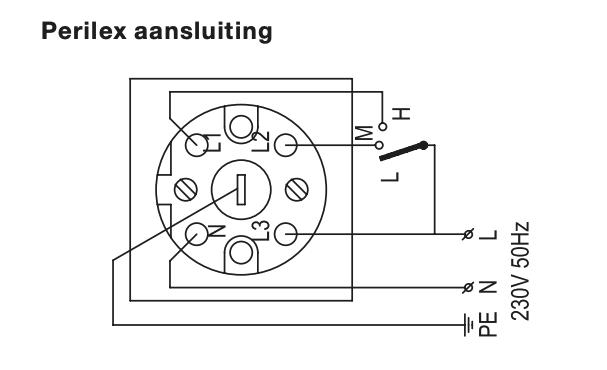

This is the product I bought
https://www.ventilatieland.nl/artikel/2 ... ekker.html
This is the connection diagram delivered with the product.
Screenshot 2021-11-01 at 11.16.06.png (38.7 KiB) Viewed 7465 times
The cables on the wall are
Yellow/Green -> Earth
Blue -> Neutral
Brown-> Live (!)
and two Black cables (named Black1 and Black2 on the sheet)
The earth and the neutral connections were the obvious ones and thats why I fixed them and didn’t change on my tests
Here is the outcome of the test...
Screenshot 2021-11-01 at 11.20.54.png (238.37 KiB) Viewed 7465 times
Do you have any idea what is going wrong here ?
any help would be appreciated!
Thank you
