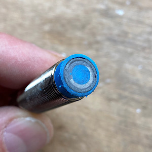

Finally received my sensor from Ali today. I made a nice holder from plexiglass.
Software and hardware seems to be in order, because if I wave a piece of metal in front of the sensor, the counter in the Wemos web interface goes up.
Problem is that wherever I position the sensor, it does not detect the turning wheel in the watermeter yet.
I probably need to grind the blue tip of the sensor. Haven’t done that yet. How much can I grind off? In the start of this topic 1mm is mentioned. Seems like a lot. Is there risk of grinding too much off?
Re: Toon App: Water
Mine works fine without grinding, did you check the detection distance with the piece of metal? And it needs to be aligned off center to work.

My sensor only detects metal when it’s within 4-5mm distance.
Yes, the hole is at the right place, but I also checked different positions on the watermeter manually but nothing is detected.

Did jou drill the hole through the plexiglas so the sensor is in contact with the meter itseld? If so, start to grind a bit of the tip of the sensor bit-by bit. I have a sensor wich has conpletely lost the blue plastic and is still working. I think the plastic is to closes the sensor for water.Arnout2000 wrote:My sensor only detects metal when it’s within 4-5mm distance.

I have started grinding. See the photo of the result. When moving the sensor manually over de meter it now detects the coil so that is good News! I can start mounting now.
Yes, the sensor hangs beneath the plexiglass so the tip directly touches the plastic cover of the meter.

Yes, it is just a plastic cap to close the sensor. Best is to mount it with water flowing.. so open one of the water tap points.

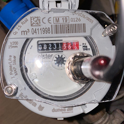

Installation complete. Works like a charm.
I only had to enter the current value of the watermeter in the ESP interface. If I enter the value on the Toon the value becomes weird. Is that a know bug?

You should enter 231562 and not 231,562 or 231.562

Yes that’s what I did. The same applies for the ESP interface. No points or commas.Jasper wrote:You should enter 231562 and not 231,562 or 231.562

You mean first days use? That's normal because it has a previous value which was reported earlier and I cannot tell if that's fixed yet. You should wait for oepie loepie then to confirm.
