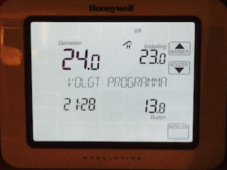

Great, it's working!
I didn't find the setting but it wasn't necessary after all (probably no option any more).
The Honeywell Touch modulation (TH8210M1003) does support overriding the setpoint out of the box, it just takes a minute or so.
The thermostat is actually displaying the fact that it is overridden by the H covered by a 'roof'
Honeywell Touch modulation (TH8210M1003) in override state
Screen Shot 2015-09-12 at 11.25.28.png (135.92 KiB) Viewed 2984 times
Thanks a lot for the help
