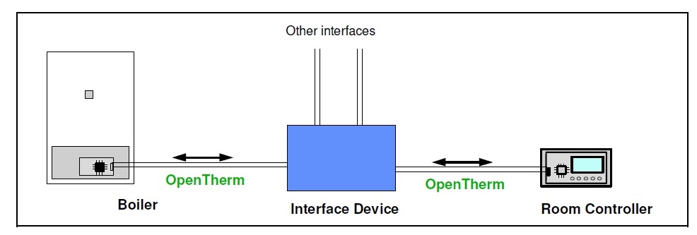

Hi, the OTGW and opentherm is completely new to me, so excuse me for no understanding your answer. The thermostat is working, I can control my CV and set the temperature. So the thermostat and boiler understand each other, right?
Now from what I understand the gateway sits in the middle observing and translating, right. How can I emulate/imitate the thermostat, so that I can (temporarily) override the room setpoint? If I send a TT=21.0 or TC=21.0 command does the gateway then instruct the boiler? Does it need the thermostat?
regards,
Michael
ps: no worries about the 'edit' of the original post.
Posts: 2031
Re: Nefit:can not set Room Setpoint?
Correct, the gateway sits between the thermostat and the boiler. The thermostat is controlling the whole show. It sends a message to the OTGW. The gateway examines the message and decides if it should send it to the boiler, or if it can answer it on its own. In the latter case it may send a different message to the boiler.
When you send a TT or TC serial command to the gateway, it stores that information. The next time the thermostat requests the "override setpoint" value (via DataID 9), the gateway returns the stored information to the thermostat. The thermostat adjusts its setpoint (pretty much as if you had changed it by hand) and then starts using that to drive the boiler. Obviously this functionality needs to be supported by the thermostat to work.
The thermostat controls the boiler (simply put) by specifying a desired water temperature (DataID 1). It determines that water temperature based on a whole bunch of parameters, of which the setpoint is only one. There is also the current room temperature to take into account (usually measured by the thermostat, so you will probably need it for that), the heat loss of the house, the power range of the boiler, the delay between switching the heating and when that results in a change of the room temperature, warm tap water requests, and possibly the outside temperature.
It is possible to instruct the gateway to send a desired water temperature to the boiler, but as you might be able to tell from the previous paragraph, that's not at all trivial to calculate. And it needs to be adjusted continuously to achieve the desired temperature. (And that's just the simplified version of the story.) Thermostat manufacturers spent years of research to get this right. So, although you can get rid of the thermostat in theory, it's so much easier to use it for doing what it was designed to do.

mfranken wrote:Ah, that is making a lot if sense. So the thermostat is the brain. From what I see in the equipment matrix the 'Honeywell Chronotherm Wireless Modulation' should support 'room setpoint' and 'remote override room setpoint'. I will investigate further.
Neither parameter will help you.
Room Setpoint (ID 16) is provided so the current required temperature can be displayed on the boiler - if the boiler support this. It is not a way of telling the boiler what room temperature is required, so it takes the necessary action.
As for Remote Override Room Setpoint (ID 9), this is a Read parameter, i.e the OT thermostat requests this info from the boiler. (How the boiler obtains the information is not clear from the OT spec.) ID 9 is used in conjunction with ID100.
The only control parameter is the Control Setpoint (ID 1), which is the required water temperature. This is calculated by the room thermostat's algorithms and logic. You would have to either design and build your own thermostat, or hack into an existing stat and override the required room temperature that way.

hvxl wrote:My theory is that the thermostat's OT interface box reuses code from another thermostat, which includes support for ID 9, but the RF interface provides no possibility to send this information to the control part of the thermostat. And so it is simply discarded.
Exactly, that's my theory too. So today I'll be receiving the non-RF version of this thermostat to verify. Will keep you posted.
D_Hailsham
Posts: 41
Joined: Tue Aug 13, 2013 10:45 am
Post by D_Hailsham »
hvxl wrote:My theory is that the thermostat's OT interface box reuses code from another thermostat, which includes support for ID 9.
The only problem with that theory is that ID 9 is a Read parameter and there is no comparable Write parameter.
The version 2.2 OT spec, on page 8, has the diagram show below:
My immediate thought is that the remote thermostat would be connected to the "other interfaces" interface of the Interface Device.
ID100, which is supposed to control how ID9 is used, doesn't make sense. Read it carefully! (That's the English version, the Dutch one may be OK.)
Posts: 2031
I'm not sure what you mean. ID 9 is a read parameter, so the thermostat wants to read it from the opentherm slave device it talks to. When using an OTGW, that's the gateway. So the gateway can return a value. No problem. It works with several thermostats.
I also don't see what doesn't make sense about ID100, other than that paragraph 5.3.8.3 defines the data as u8/flag8, while 5.4 says it's flag8/-. The gateway has a serial command to select whether the flags should be sent in the high byte or only in the low byte. I have not found any thermostat that honours the manual change priority. Program change priority usually does work for thermostats that request ID100.
I don't think the picture on page 8 applies to the current topic. The OT interface part of CMT957M1011 doesn't sit between two opentherm connections. It talks OpenTherm toward the boiler (or OTGW) and probably some proprietary protocol on the RF interface. So, as far as opentherm is concerned, the R8810A1018 is (represents) the room controller. Unless I misunderstand what you mean.
