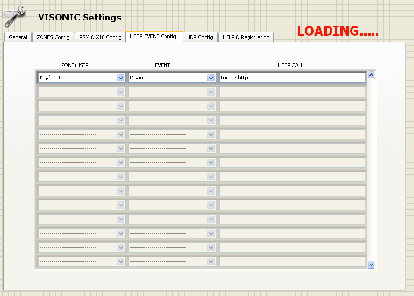

John to clarify, I was thinking of this solution;
user event.png (34.01 KiB) Viewed 14223 times
So u can make your own triggers, by selecting from the list
Zone/User; are keyfobs,zones, Pincode users, Proxytags etc
Events; Arm, Disarm, tamper, etc
HTTP Call; is the http url the program triggers.
This is really the A7 message from the panel for the geeks :)
Will this suit your needs? Or do you also need an ON and OFF URL, which makes it a bit harder for me :P?

Possibility to trigger HTTP Calls by adding rules in the settings/USer Events Tab. Now users can trigger http calls upon for example:
Keyfob 1 Disarms
ProyTag 7 Arms
etc etc
BTW keep in mind that the application closes after 2 hours when not registered.. :oops:

bartbakels wrote:[
Regards
This looks like it will suit my needs completely, including the ones that I was not aware of yet :)
Thank you very much!!
