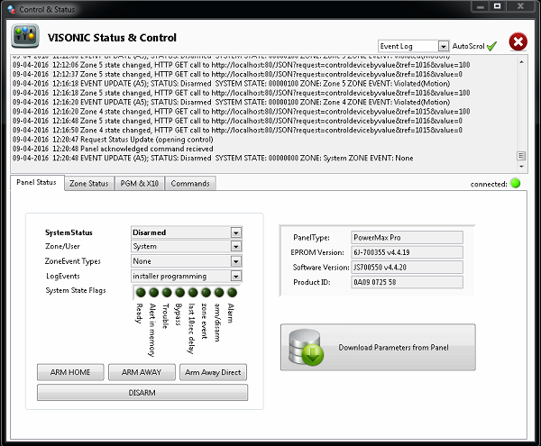

mainpanel
mainpanel

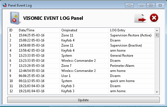

EventLog:

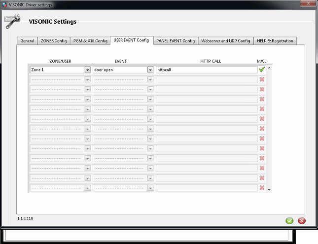

Settings
Settings

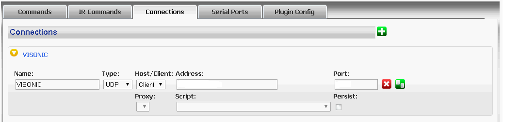

to send UDP request from HS3,I used the IP/Serial Plugin from Drule; http://board.homeseer.com/showthread.php?p=1206098 Plugin
1. Configure the connection, fill in IP and configured port of the machine which runs the VisonicDriver;

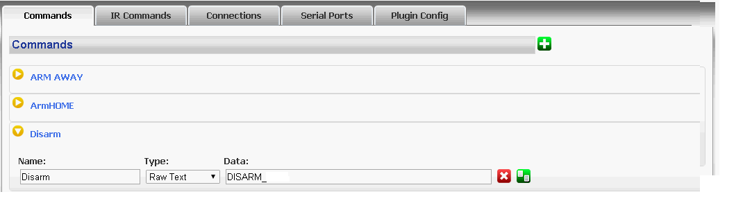

2. Fill in the commands.
DISARM_[securityPostamble]
ARMHOME_[securityPostamble]
ARMAWAY_[securityPostamble]
X10|[X10ID]|[ACTION]_[securityPostamble]
PGM|[ACTION]_[securityPostamble]
[securityPostamble] = can be set in the VisonicDriver Settings
[X10ID] = X10 Address; X1 t/m X15
[ACTION] = ON; OFF; DIM; BRIGHT, for PGM only ON and OFF
Security Postamble can be configured in the settings
3. Create an event with the connection and command to be send, created in that plugin.

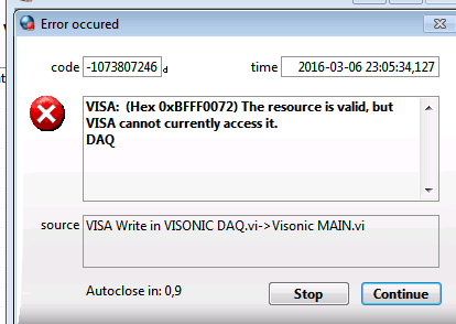

After saving my comport I get the attached
Schermafbeelding 2016-03-06 om 23.05.00.png (21.44 KiB) Viewed 48824 times
groeten,
bartbakels
Posts: 515
Re: VIsonic (Powermax) LV Interface application
Post by bartbakels »
Phaeton,
Make sure the comport is not in use by another application and did you reboot after installation?
Bart
