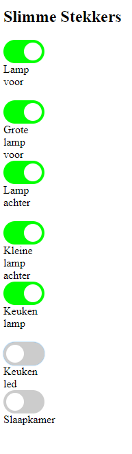

Nice to see this one as a app. I always used the Quby version, with a lot of my own work in it, including support for me smart plugs. Like:
And support for me smart smoke alarm.
It is certainly not finished yet, just do not get ready to finish it.

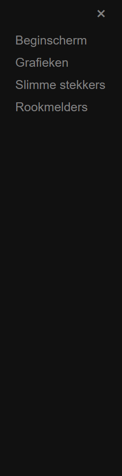

So I have also built a menu in it, such as:
