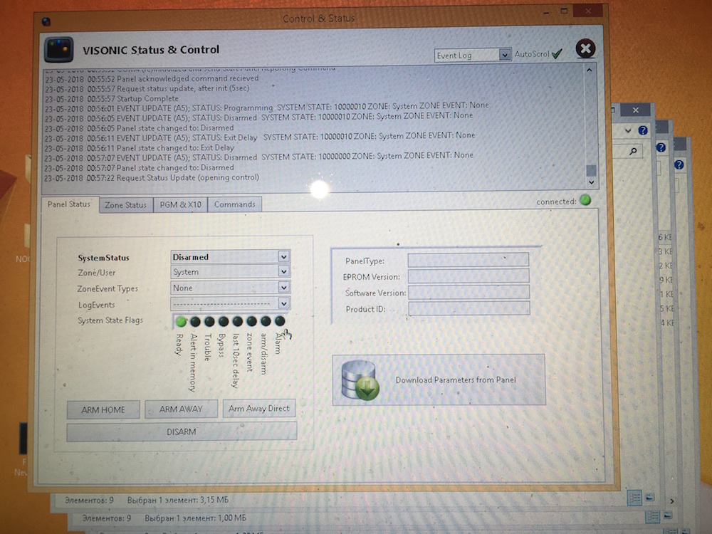

Hi, is it possible to "arm away" or "arm home" in instant mode with this app?
I use it with "arm home" at night, to make perimeter sensors around house work without "entry delay".
According this, PowerMax plugin for Vera can do it and use same interface, http://code.mios.com/trac/mios_visonic-powermax
thanks.
thanks.

Getting armed status from HS3
Hi Bart
Sometimes HS3 looses sync with the visonic driver status (armed, disarmed, arm, home, etc). How can I get the armed status from HS?
I tried http://ip:3011/VisonicDriver/jsonget?se ... tionString but it only returns {"Alarm":"FALSE","Alert in memory":"FALSE","Arm/disarm":"FALSE","ByPass":"FALSE","Last 10 seconds delay":"FALSE","Log Events":"","Ready":"FALSE","System Status":"","Trouble":"FALSE","Zone Event":"FALSE","Zone/User":"","ZoneEvent Types":"","Zones State":]} without status about the arm status.
Also, anyway to do something similar to get the status of each zone?
Thank you.

hello
do you know what can be wrong? my powermax complete only shows current status of panel(disarm, delay,armed...) (with some lags) but doestn show any other information (panel info, zones etc.) and doesn't react on pressing arm or disarm in windows app.
thanks
thanks
- IMG_9143.JPG (272.07 KiB) Viewed 20961 times
