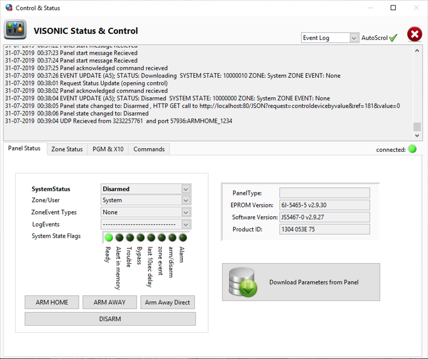

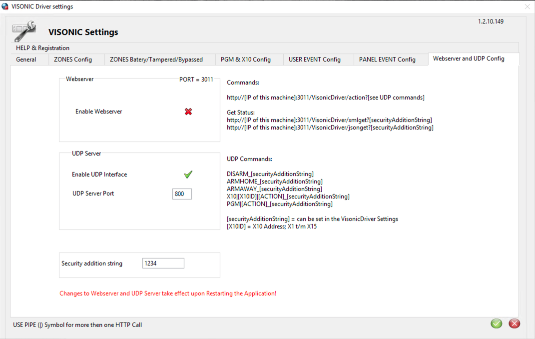

I've been using your software for quite a while with HS3 and it happily reports status changes from the Visonic app to HS3, but as yet, I haven't been able to ARM/DISARM the panel from HS3 (or even just a UDP call) I am able to arm/disarm the panel from the software, but I can't make a call to make it happen. I'm attaching my current configuration and my event log.
This is the call I'm making on my mac to initiate the UDP call: echo ARMHOME_1234 | nc -w1 -u ha-lenovo 800
The software version is 1.2.10.149
Do you have any suggestions on what I should be doing differently?
As an aside, I haven't been able to get the http server to work at all, even with the firewall entirely turned off.
Thanks for your help!
Cheers,
Duane
Event Log
Event Log
Screen Shot 2019-07-31 at 12.39.55 AM.png (279.23 KiB) Viewed 19784 times
configuration
configuration
Screen Shot 2019-07-31 at 12.37.56 AM.png (199.63 KiB) Viewed 19784 times

duaneo wrote:Hey Bart,
Cheers,
Duane
Duane,
Hmm i dont use the UDP feature anymore but it should work. How do you trigger this? i ussed a HS3 plugin fo this in the past, i think it was IPSErial plugin (https://forums.homeseer.com/forum/devel ... d?t=169754)
next to that i think the message in the log says it comes in at a dirfferent port no. which indicated its not being handled.
The webinterface should work as expected? do you get any errors? when starting up? Can you navigate to the json or xml status page? Make sure the labview runtime is not blocked in the firewall indeed.

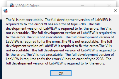

Hi Bart, I get the attached issue after installing the application after a hard drive crash. I use windows 10 and the app always worked well. Any ideas how to fix?
groeten,
phoenixb
Re: Visonic Powermax Interface (Windows) application
Post by phoenixb »
I had the same problem with an clean install.
I have solved this with an reinstall of .net 3.5 that was comming with the full install of labview 2009.
Windows give me the info that it was correct installed on the pc but unfortunately there was missing some important parts.
Maybe it's also enough to only install.net itself.
__________________
Phaeton
Posts: 573
Location: Wassenaar
Post by Phaeton »
Thanks a lot. This worked. The app starts.
Unfortionately now the app doesn't activate. I will contact Bart through email about this.
