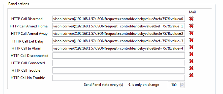

bartbakels wrote:The application handels the alarm and condition... so dont really understand ur question
I have a line like this in the "Panel actions"
But it's never called
The rest of the lines are called just fine.
Re: Visonic Powermax Interface (Windows) application
Posted: Mon Jan 14, 2019 1:43 pm
by bartbakels
Mario,
That is indeed how it should be configured. maybe u can send the config file so I can check, or can test if the application send an email upon alarm detection I use it in exactly the same way. Maybe can you also provide the logfile when initiating an alarm.
regards
Bart
