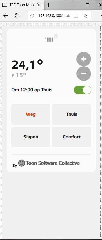

In recent days I have been busy giving the Toon Mobile a fresh appearance. The intention is that it will be expanded.
Toon mobile.png (33.27 KiB) Viewed 37630 times
For the basis I have to thank someone .. Thanks Jankootje for the layout.
Not much has changed so far. Layout is the biggest change you will notice.
The following things are also coming:
- Current gas and current display.
- smart lamps / plugs
- CV boiler (So you can see the Water pressure, etc.. Keep in mind that this one will only work if Toon is OpenTherm on you're CV boiler!!)
- Other things that you like to see
When comes this one in ToonStore?
As quickly as possible.
