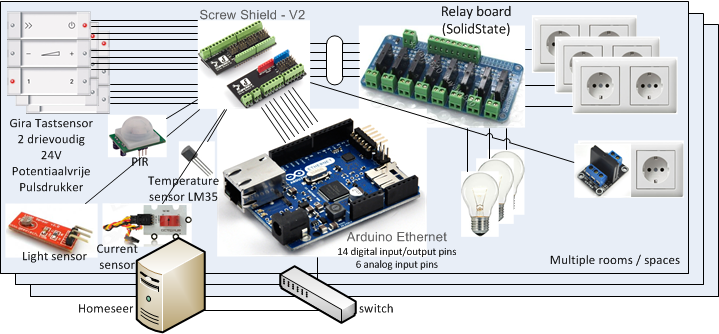

Your post is quite long, so i didn't read it all in detail. But maybe you could have a look at Domoticz, running on a Raspberry Pi ? Can be used with a relay board connected to the GPIO pins (however you are limited to the amount of GPIO pins then), or with ZWave (Aeon USB-stick), or with RFXCOM. I use the RFXCOM with about 9 wall outlets (KlikAanKlikUit) and it works fine. Nice and affordable solution.
Re: switching all power sockets and lights
Hi Vince,
I've read your project-to-be and am intrigued by it. I myself use Plugwise and I can tell you that the system is perfect. As long as you have enough devices to cover the ranges and the devices are configured it works flawlessly and fast. The only two problems are that you cannot switch them at the socket (no physical button) and that they plug into the powersocket (no integrated solution).
That said, I'm currently experimenting with Arduino and ethernetshields to create POE LAN connected devices which can do different things. Arduino because it is flexible, because you can program them to do whatever you want and change it at any time and ethernet based so there is no problem with wireless interference. When using a Arduino Nano with a ENCJ ethernet board, you have a costeffective and (relatively) small solution (~10 euro per set --> http://www.aliexpress.com/item/Free-shi ... 83818.html). When combining this with MQTT this is the perfect base to create various solutions for lighting, powercontrol (with a relay for example), sensing (pirs/temperature/humidity/..), etc.
The challenge is that you need wires for low power (~5-12 Volt) and normal power (230 Volt for the power and lighting) at the sockets (these may not be combined in one PVC pipe). Maybe it's an idea to take a socket (I mean a "lasdoos" which is normally put in the wall) and check is the arduino nano/ethernet/relay fits in the socket. I would love it if you post your progress and experiences on this project.
p.s. I'm currently not busy with the 230 V switching, but am in the process of developing a roomsensing board (arduino nano/enj ethernet board/pir/hum/temperature sensor/MQTT/homeseer). 230V switching would be next.

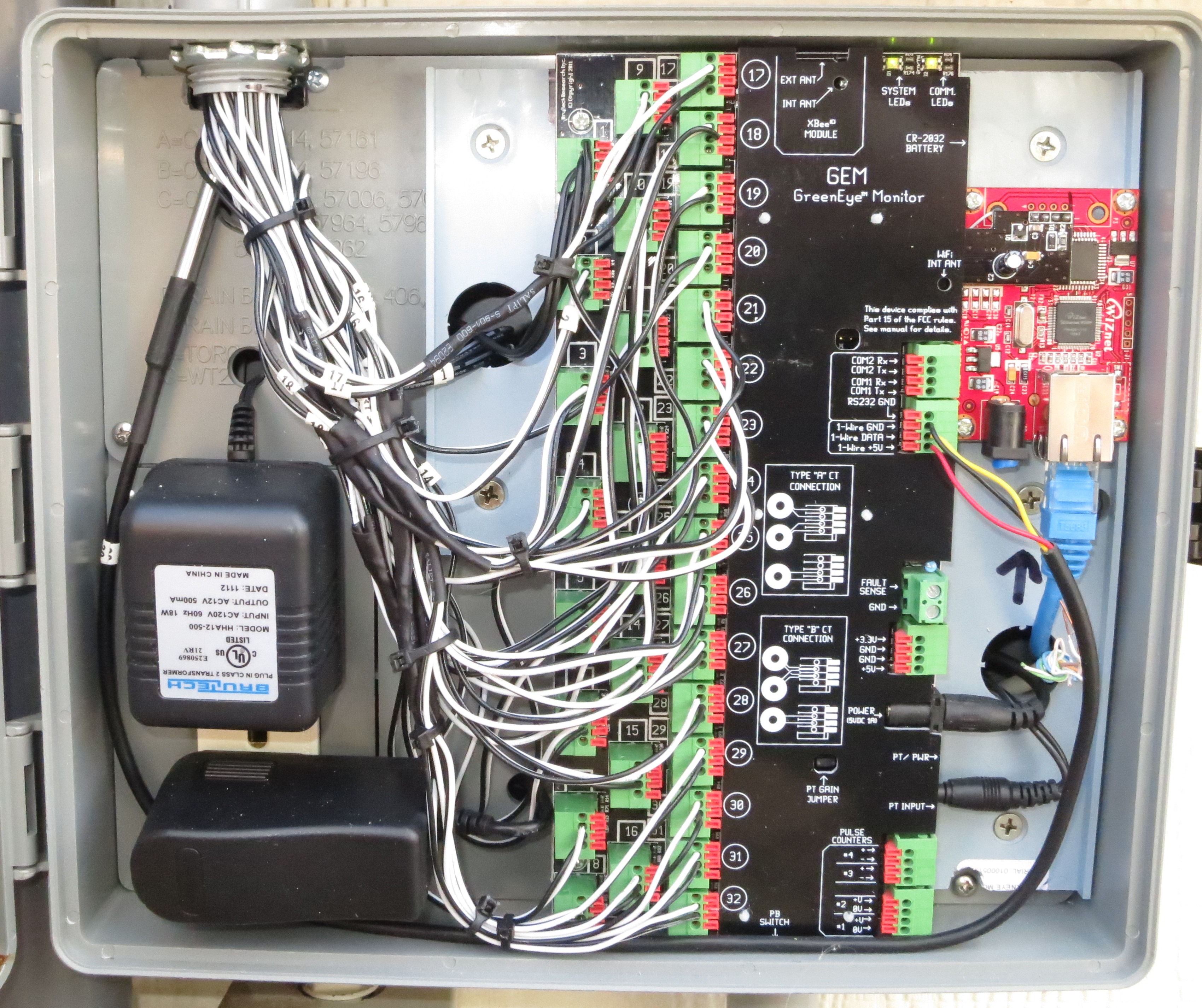

Well, i have contact now with Brultech about the energy monitor system they sell.
brultech.com/home/store/category.php?id ... ategory=34
I got these pics from the HS forum but this is what it looks like what they use, you put small CT rings around the cables and then you get the real time usage like plugwise.
http://www.prades.net/HAStory/Images/IMG_1141.jpg
http://www.prades.net/HAStory/Images/JPEG/IMG_1150.jpg
So in my case i would need 1 central point where the Green eye monitor is placed, it can accept 32 points to measure for CT rings, it has i believe 4 or 6 measuring points for pulses, like a water meter /gas and 8 contacts for 1 wire temp sensors.
I do think when i want to measure all lights and wall sockets i will exceed the 32 contacts but tomorrow i can count this since i am putting the last autograph and get the key.

For the switching relays, i have been looking what kind of solution i would use i choose the mechanical relays since they have more advantages compared to the SSR in my eyes.
I hope to be able to find something small that can switch 25A or more because when a for example machine that draws 2500W and is always on, when i switch the relay on it draws very high Amps i have read on a website just for a few milliseconds.
I do not like to replace all the relays every week because of burned contacts etc.
The smaller they are the better i can hide them , and hopefully in the boxes itself , if i can't i will have to place a small box near the contacts that looks good (as far that is possible)
I have some experience with a similar measuring system like this green eye monitor , i have a openenergymonitor.org (emonTX) laying arround and that works pretty good i must say but since i do not know how to write code/program and there is no plugin ready to use for homeseer i can't use this and it also contains only 4 ports per unit that cost about 70 euro for a set i think ive paid.
Some questions i have asked to the brultech creator is , do i need to use shielded wires , or not.
i know that because when the capacitance increases it will screw up the readings, so i am not sure if this is the same with the CT data it sends back, and indeed if it is possible to lay next to lines that get 5V or 12V trough them.

Maybe also an idea to use the Arduino Ethernet board in a semi-decentralized system (instead of the Nano).
You have several digital Inputs/Outputs and Analog Inputs with an ethernet connection for a reasonable price.
Of course it has to fit in the situation but I like the idea of utilizing the existing LAN.
I have not installed this in my home yet but I did order some Arduino stuff to see if it works out for me. What I want to achieve is that also the inputs (pushbuttons) are readable in Homeseer to switch things or run events/scripts. The board has analog inputs and maybe you can use them to read the current if necessary by using a current sensor. I am also no programmer so my intention is to make use of the plugin Greig wrote for Arduino.
For the relays I would go for SS because of the advantages you mentioned. In my opinion 2A should be sufficient in most cases, only were needed I would use a 25A SS.

Thanks peter,
Actually i am already using the arduino mega 2560 rev 3 because of the ports and the ethernet shield.
I am going to give all the sockets in the wall and light switches there own cable, bought 400m YmvkMB 3g2.5 cable.
The SSR i am not going to use because of the danger of them, since the more Amps they can handle , more power they let go trough an then the heat dissipation that has to be on them. ( also the vampire draws that are still there when its turned off is a thing i do not want)
What i am no going to do is bring all the cables to 2 central points, the garage part has his own fuse box and the house.
all the sockets from the living room and the other 3 rooms and bathroom toilets etc going to that location.
Using a wall mill then going to close them up with new cables to each socket.
