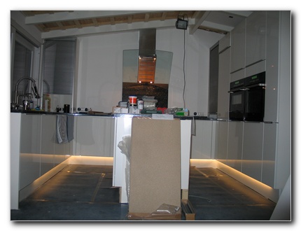

Using 3528 strip with 150 leds per meter would be more then enough light, what I was planning for the same project is a Aluminum L (15 or 20 x 10mm) strip long edge used to put the LED strip and holes for mountingto the underside of the steps with the 10mm side to cover the direct light.
I have done this already in my kitchen and must say the result is not bad at all, on the picture it is dimmed to 40%
- Kitchen with LED light under cabinets
- thmb_IMG_7868.jpg (42.14 KiB) Viewed 23355 times

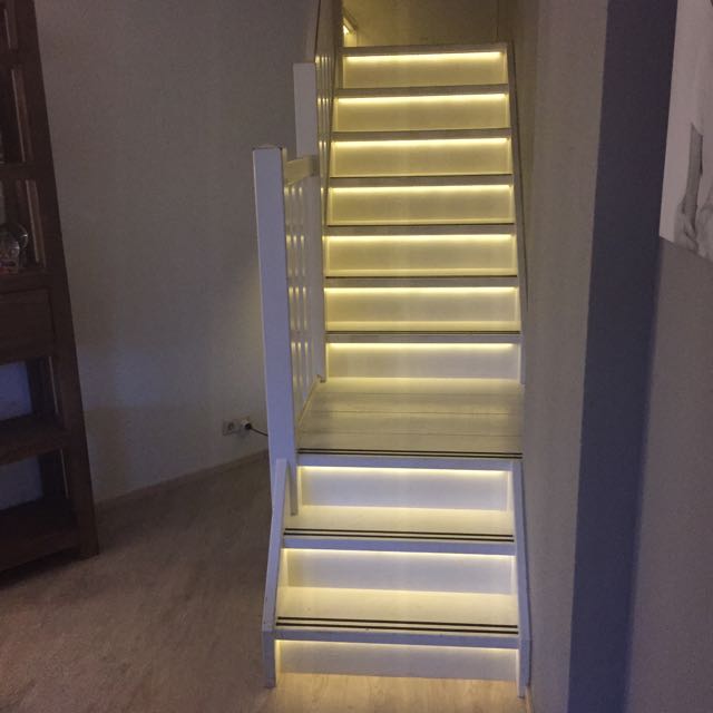

As promised a picture of the result. I'm pretty proud of the result....
- IMG_0455.jpg (41.06 KiB) Viewed 23062 times

Re: LED Stair project
how do you switch them , by movement detection ? looks great
Looks very nice!
See attached photo. This is what I bought to put the strips in. For protection and a diffuse lighting.
These are not cheap, in facts it was about 60 % of the total costs. You can buy them at LedStripKoning.nl
I used a Fibaro RGBW devices to control the strips. I devices the stairs in 3 sectors and can control/dim the 3 sectors independently.
For now they are controlled by HomeSeer events, I will add motion sensors later but than also controlled by HomeSeer.
It's nice to control every step independently, but for me it's enough to have the stairs decided into 3 sectors.
