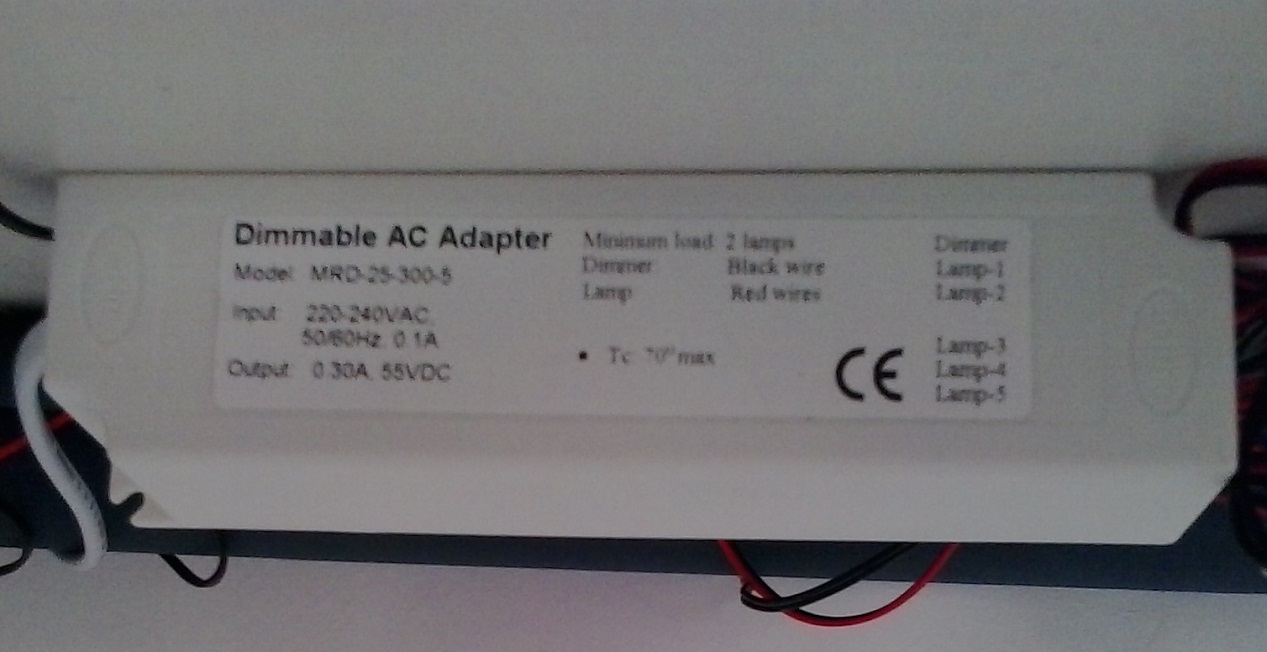

But in my case there's another caveat: apparently my LED-driver (and hence my LEDs) are operating with 55V, not 12 or 24V. I'll attach a photo.
So what do I do now?
- LED Power Supply (LED-driver)
- 20150312_151636.jpg (169.27 KiB) Viewed 32961 times
