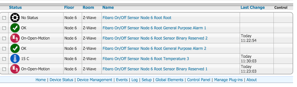

Akatar, just did a quick test with one of the 'Italian' sets:
First inclusion showed only 1 'reserved' node but after I connected yellow and green wire to GND for a while it suddenly popped up and started to work.
Do you see the same nodes as me?
Screen Shot 2015-10-18 at 11.32.11.png (162.48 KiB) Viewed 19293 times
Tried a full reset?
In my case when I hold yellow or green wire against (blue) GND it switches the node with a small delay of 1-3 secs.

i do see the same nodes, i will connect yellow/green/blue and see what happens
