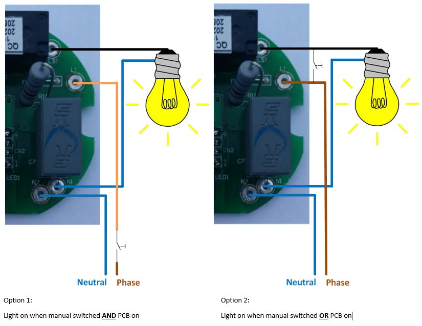

I want to use this at some indoor lights. Three questions as I am not a real electrician:
1) can someone explain how to connect the wires (line=brown / neutral=blue / switch=black) when I want to put this between an existing light an existing switch.
2) I assume the existing switch still funcions ?
3) Can I also use it to switch "TL"-lights (don''t know the right English name for it..)
In the meantime I found that this device can switch lights of max 100 Watt.
Can anyone please answer my questions ?

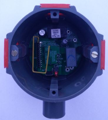

Broes
Posts: 74
Re: Using EM6555 PCB in outdoor light fixture
Post by Broes »
It fits, see picture (50 mm "inbouwdoos").
Dimensions are 50x53x25 mm

Mai Pensato wrote:Very interesting solution with this EM6555 !!
According to the specifications it should be possible to switch energy saving bulbs so probably it will work with a tube light.
But because of the high inrush current the relay contact will probably last longer with a resistive load.
I changed the load in my first post to 100 Watt because it looks like domotica-shop has is to optimistic with 500 Watt.

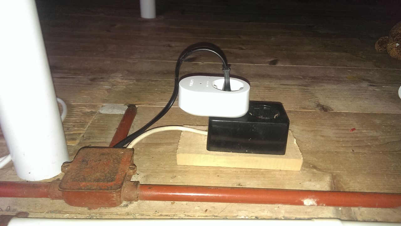

I had a defect KaKu YC1000 plugin switch that i gutted and i placed one of those units inside the casing. It fits perfectly and now i have a 100W Z-wave plug for just 15,- :D
