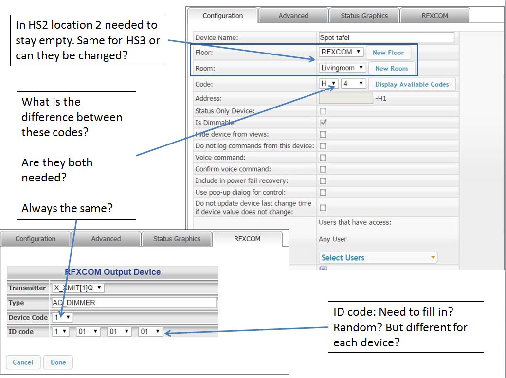

I recently upgraded to HS3 and I wanted to start clean (So I will create all devices by hand).
I have some questions about creating KAKU output devices in RFXcom plugin. (Both AC and ARC devices/dimmers)
The questions are probably more clear in the attached picture but here they are:
1: There is a code (house) code in the config tab like "H 1" but there is also a "device code" in the RFCcom tab. What is the difference, do they need to be the same?
2: The ID code can be randomly filled. but does this mean I can keep them the same for each device? Does it do anything?
3: In HS2 the location2 needed to stay empty. is there also some rule for the 2 lacations in HS3?
I checked the RFCcom manual but could not get clear answers on these points. As I will be creating many devices I just want to make sure I do it right the first time.
They can be different but it is preferred to use the same device code.
The ID + device code is used by the module. So ID's can be the same.
The ID is in fact the code of an AC remote.
Location2 can be activated somewhere in the Homeseer configuration.
