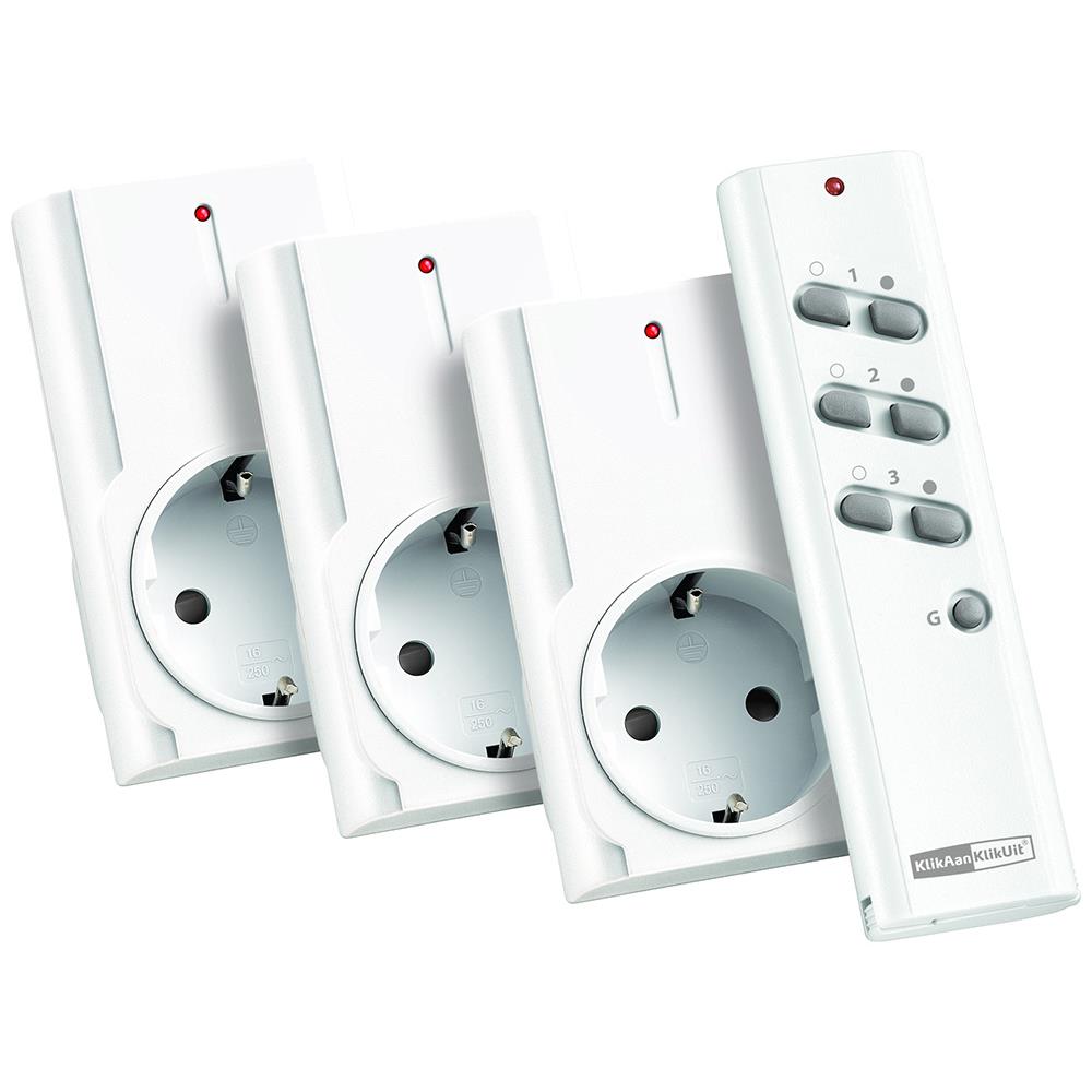

I recently changed all wiring of the OTGW that solved the issue of not working at all.
Now I have a cronjob that cuts the power and restores it after 5 minutes if I don't receive any updates from OTGW.

Interesting... what are you using to "cut the power"?sincze wrote:Now I have a cronjob that cuts the power and restores it after 5 minutes if I don't receive any updates from OTGW.
Could be a life saver when you realize your otgw (or another device) is stuck and you can't simply reset by issuing the proper command...

A well the 'cut' the power is a KAKU switch. So 433 mhz signal will tell it to switch off.emmeesse68 wrote:Interesting... what are you using to "cut the power"?sincze wrote:Now I have a cronjob that cuts the power and restores it after 5 minutes if I don't receive any updates from OTGW.
After 3 minutes it will send the ON command and de switch switches on.
