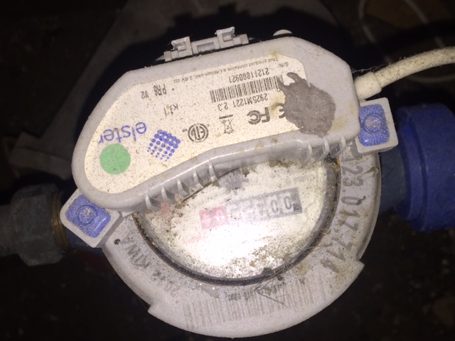

i just asked for the watercompagny for a meter with a output for a external counter
and they did installed one

What meter did they install and which external counter do you use?

they installed a meter with s0 output, i connected a rfxcom pluse counter

Akatar wrote:they installed a meter with s0 output, i connected a rfxcom pluse counter
Vitens? And if so what brand of meter did they replace the old meter with?

deze, komen minimaal 4/5 draden uit
is op diverse manieren uit te lezen
ik zit in groningen, zal geen vitens zijn?
