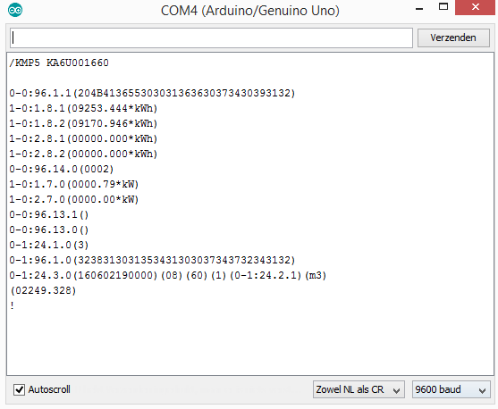

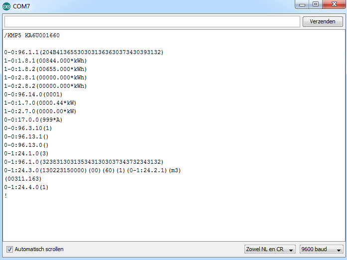

When i started writing this post a year or several back: http://domoticx.com/p1-poort-slimme-met ... n-hardware , it seems the telegram of the P1 port (in this case a DSRM 2) has changed, i've tested it again today...some values are missing, like:
0-0:17.0.0(999*A)
0-0:96.3.10(1)
0-1:24.4.0(1)
Have to look up wich info/values they represent....
Have you experienced the same?
2016-06 telegram
p1 arduino uitlezen 2016-06.png (14.63 KiB) Viewed 7918 times
2013-2014 telegram
p1 arduino uitlezen.png (24.8 KiB) Viewed 7918 times
Posts: 2029
Re: Firmware update last year(s)?
I see the same thing with my DSMR 4 device. On March 27, 2015 those exact same parameters were reported (although in my case 0-0:17.0.0 said 999.9*kW). Today they're not there any more.
