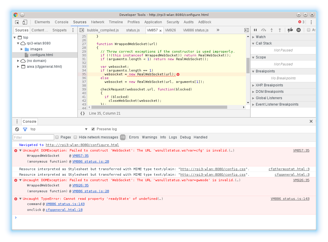

Hi again,
I tried to use Chrome's Developer Tools to do a trace. Below are the error messages when navigating to Configure->Miscellaneous->Gateway.
I've attached the full contents of the Developer Tools window
Navigated to http://rpi3-wlan:8080/configure.html
Resource interpreted as Stylesheet but transferred with MIME type text/plain: "http://rpi3-wlan:8080/config.css".
Uncaught DOMException: Failed to construct 'WebSocket': The URL 'wsnullstatus.ws?var=cfg' is invalid.(…)
Uncaught DOMException: Failed to construct 'WebSocket': The URL 'wsnullstatus.ws?var=gwmode' is invalid.(…)
Uncaught TypeError: Cannot read property 'readyState' of undefined(…)
Seems, the WebSocket cannot be created. Any idea what goes wrong here?

Posts: 2029
Re: [Web Server] Cannot issue Free format commands
The 'wsnullstatus.ws?var=cfg' is wrong. That should be 'ws://rpi3-wlan:8080/status.ws?var=cfg', but the regular expression that extracts the host name and port part doesn't handle the '-' in your host name correctly. It should work OK if you use the IP address, or create an alias FQDN that doesn't have a dash.
I'll fix the code.
