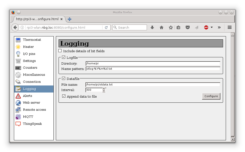

Posts: 2031
Re: Long Term Visualization of Heating Behavior?
If you have OTmonitor running, you can configure the datalog to save a record of the items you are interested in at regular intervals. Then the only task left is to make a graph out of that.
Bororo

If cloud is not an issue I suggest to use built in Thingspeak support.

Post by tzieg »
hvxl wrote:If you have OTmonitor running, you can configure the datalog to save a record of the items you are interested in at regular intervals. Then the only task left is to make a graph out of that.

tzieg
Posts: 16
Joined: Mon Jan 09, 2017 10:31 pm
Post by tzieg »
Hi Schelte,
Good to hear it works for you --so something must be different on my side.
I did some more experiments:
  • I realized: the behavior for gui and daemon mode is the same:
    - after entering interval, data fields, and filename for the first time using the gui, all works as expected
    - if restarting in gui- or the daemon-mode, the datalog does not work
  • The user for daemon mode and gui mode is the same.
  • Checking the configuration via the web server shows the check mark for the datalog and the append mode (see attachment)
  • If I use this command line
    /usr/local/bin/otmonitor --daemon --datafile=/home/pi/otdata.txt --append
    the datalog works as expected.
So, it seems, the settings in .config/otmonitor/otmonitor.conf file are somehow ignored in my system (raspberry-3, debian jessie, otmonitor with the 'dash-patch' I've sent a few weeks back).
I can live with this solution, but it's strange that the system does not behave as it should.

Screenshot Datalog Settings
