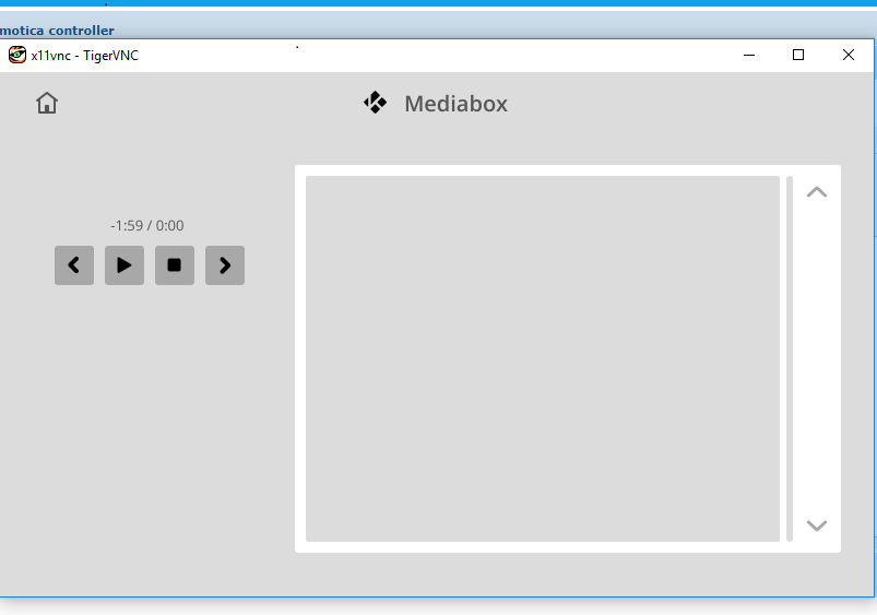

I know its been 2 years ago, but i`ve installed the kodi app, latest firmware on the Toon
it has connection but nothing shows up in the screen.
see attachment.
Is there a way to fix this?
