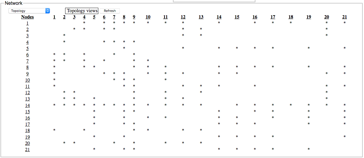

Anyway; I have spent a lot of money on this junk, so I want it to work. Yesterday I took an afternoon off to rebuild my Z-Wave network. Flickering the switches are a real PITA indeed, and I wonder how child-playing-disco resistant it is, but I got most devices on the network this way. A power-cycle is not necessary. Three devices didn't want to join, not even after power-cycles, but those could be brought back to their senses by pushing the button on the module, which is even more of a PITA. Some modules reported false devices, but I was able to fix that. Did anybody else see false devices on their modules?
The Aeotec Z-Stick now has an external antenna, which seems to make a big difference. Unfortunately I don't have an image of the network topology with the internal antenna, but with the external antenna it looks like this:
Z-Wave topology with external antenna.
Z-Wave topology with external antenna.png (57.33 KiB) Viewed 23923 times
Please note that node 18 has been disconnected from mains. Does this look like a healthy Z-Wave network to you guys?
Node 21 is very slow: Response times when operating it from the webpage of 20 seconds or longer are rather norm than exception. I did not yet check all nodes, but I've already noticed that some show erroneous statuses.
Congestion could be problem: Two nodes generate a lot of metering packets, resp. ~15000 an 8000~ in the past 12 hours. But then again; That's just one packet per 3 seconds, hardly congesting the network.
