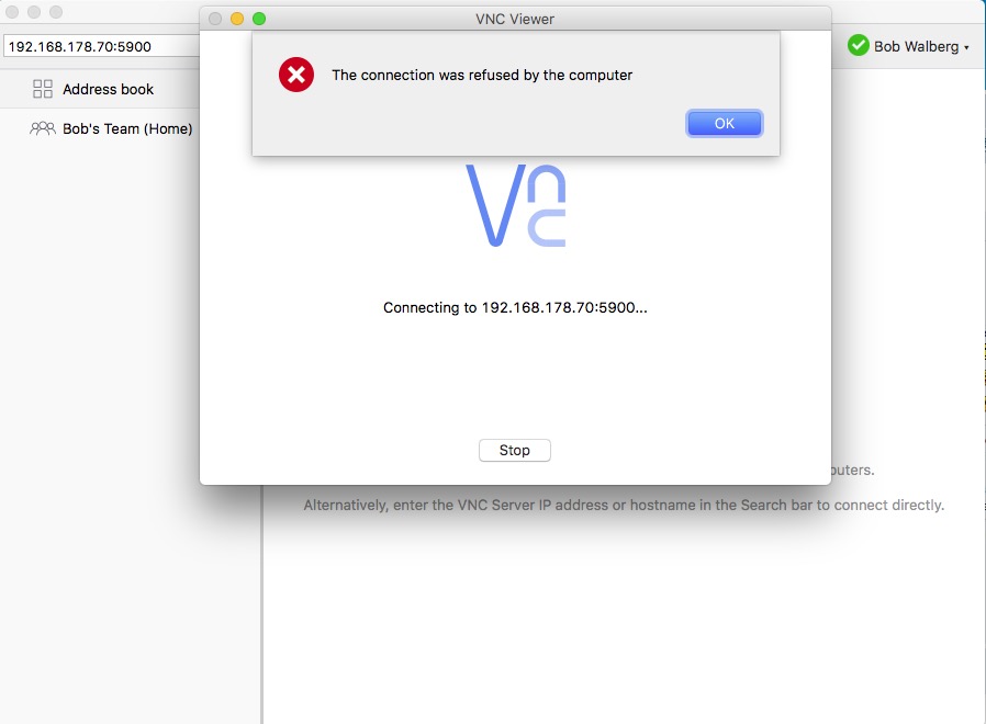

Schermafbeelding 2017-09-16 om 14.11.50.jpg (56.04 KiB) Viewed 15545 times
Yes ik got it but if i try to connect it refuses

Have you opened port 5900 on the Toon in the /etc/default/iptables.conf ?
Password has been set when you first ran x11vnc on Toon. Stupid question maybe: is x11vnc running on Toon? Installation itself is not enough, you have to start it as well.

yes i followed the documentation install x11vnc accessing Toon through VNC. i also reboot twice. But how can i check if VNC on the toon is started.

if you issue the 'top' command in a shell you will see the active processes.
Somewhere in that list should be x11vnc
Or start it again in a shell with the command 'x11vnc'. If it responds with port 5901 than it was already running also on port 5900

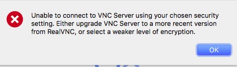

Schermafbeelding 2017-09-16 om 14.41.07.jpg (23.8 KiB) Viewed 15539 times
Aha, is was not started as it calls 5900
but now i have more info on the connection problem:
Too bad i can not see some settings on the VNCViewer to lower the security setting.

I have no experience with RealVNC. It should be working fine from your Android phone though (connection type Basic VNC)

On my mac I have choose let VNC choose the encryption and that works.

michel30 wrote:On my mac I have choose let VNC choose the encryption and that works.
I found that and i have changed it to server (let VNC choose) but the error still stays. What about the user name?
