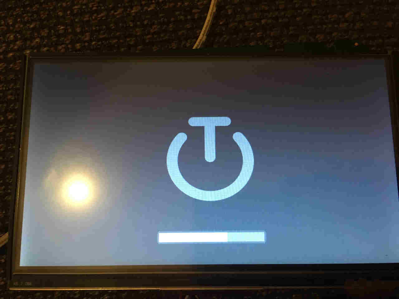

Ok I'am bit further. The MAC address of the WiFi card is still all zero's.
And also the display with tiles is not displayed.
The display lookes like the on attached to this post. It stucks on this display and after a whilte the display becomes black.

marcelr wrote:Can't see anything :? Please try again.
I can see the attachment now, loading bar(4.16.8 style) is 60% full, 40% empty.
Looks like the GUI files are broken/missing.
