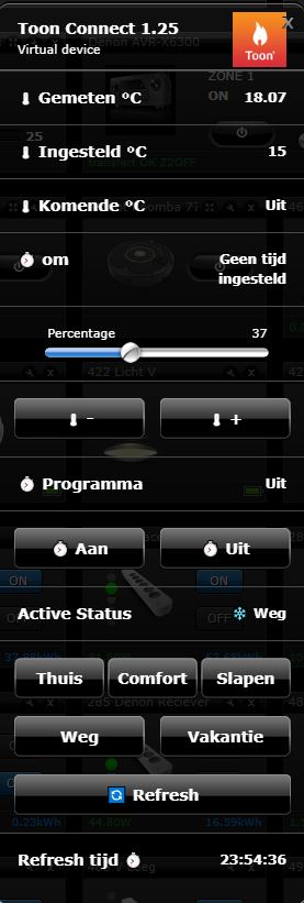

Here is the virtual device as requested,
there are now two virtual devices.
toom connect updated to version 1.25
Toon data version 0.2
toon connect 1.25:
> adjustments on the label naming to provide a beter blok programming experience
> minor bug fixes
> extra functions
toonconnect 1.25.JPG (48.44 KiB) Viewed 16345 times

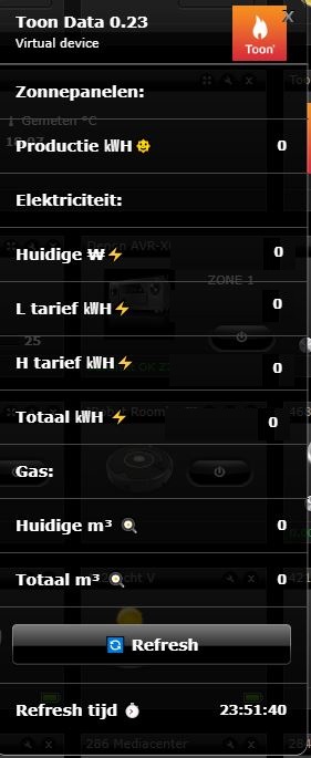

toon data 0.23:
displays statics data from the toon.
has beta status.
toondata 0,23.JPG (57.07 KiB) Viewed 16345 times

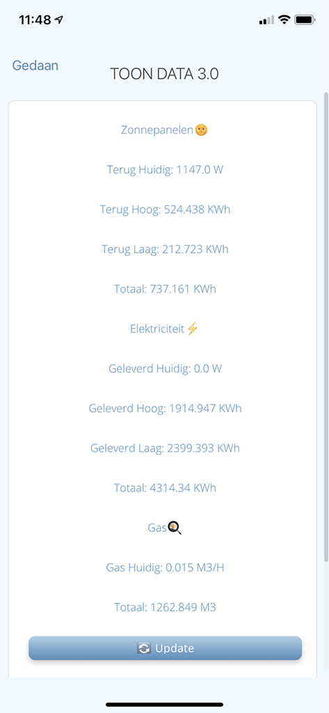

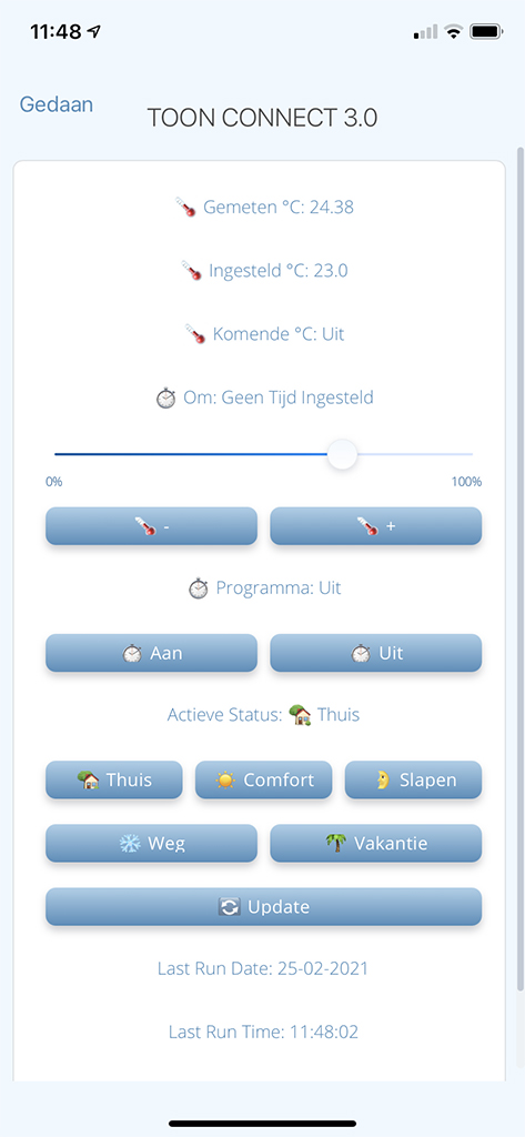

I got my HC3 to replace my HC2 last week, and been busy converting everything manually, I have lot's of LUA in my HC.
And also converted the VD by fkruis to a HC3 QuickApp.
I have them attached to this post.
Both QuickApps will start updating within 1 minute and keep doing so every minute automatically.
All functions work like before.

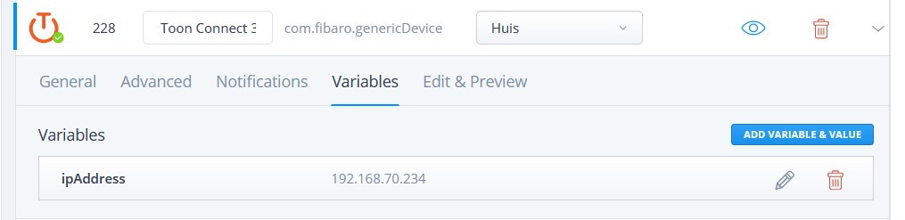

Just change the IP address for each QuickApp in the QuickApp Variables to the IP of your Toon and it should work:
Toon_Connect_3.1.fqa.zip
Bug fix for local QuickApp variable change.
(3.02 KiB) Downloaded 434 times
Toon_Data_3.0_VAR.fqa.zip
(2.11 KiB) Downloaded 397 times
Toon1 running firmware 5.33.9 (rooted)
