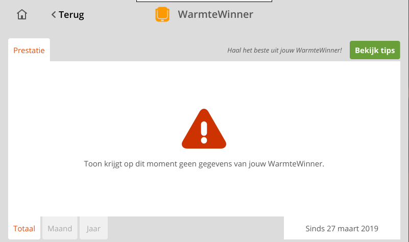

Post by mAiden »
You can also activate it without warmtewinnaar, but it is useless..
Activate this setting in scsync file:
<HeatWinner>1</HeatWinner>
And you got the this on Toon after a reboot :)

Quby (or Inventum?) have defined their own Opentherm IDs for the warmtewinner (in the range 128-255). Easy to intercept and emulate if you have one, otherwise quite useless.
