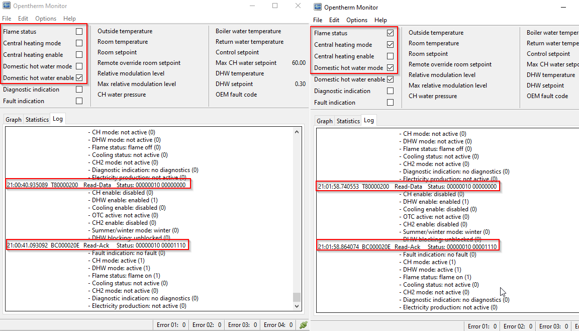

I have used the standard settings from the led. So Yellow is burner on and the second led (green) is used for communication. The Yellow led for burner on is flashing every second.
Your correct, I only show an single message. Just for clarity I included now an screenshot below. The following status bits are changing every second or faster from on to off.

Re: OTGW Nodo shop keeps on flashing/toggeling LED's
Posting screen shots is not the most useful way to show logs. In addition, the screen shots show nothing unusual. Both show the exact same data and nothing that would result in a flashing flame LED. The two messages that you circled in the two screen shots are the request from the thermostat and the response from the boiler. In the request, the slave status bits will be 0 because only the boiler can provide this information. The design is that the flame LED will only react to the bits in the response.
So far I have not seen any evidence that the OTGW is behaving incorrectly. So reflashing the firmware, changing the serial connection, or even building a second gateway seems like chasing ghosts to me. I would suggest to first try to determine what the actual problem is.
If you want me to help, please provide a log that shows a few minutes of data, and not just one individual message. You may switch of the bitfield details to reduce the size of the log. I don't need those.
