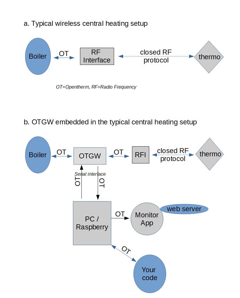

Well .. I did read your site upfront but just didn't get it 8) ..realize that I'm not familiar with the particular context at all.
Your site is full of tech specs but the context is assumed known and the functional setup should be distilled from text.
Realize these are a big steps for someone unfamiliar to the field.
What helps people like me is a higher level functional design graphic. I attached an first draft of such a diagram.
I can't attach the opendraw document for you to expand or correct errors. If you want it, let me know a way to get it to you.
Thanks for you patience
A
OTGW - Functional.jpg (92.97 KiB) Viewed 4370 times
