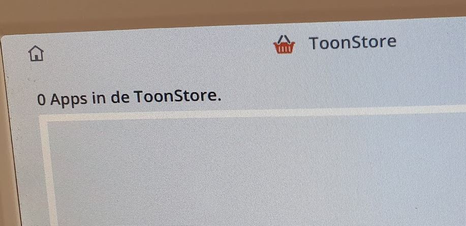

My ToonStore 5.0.9 is empty;

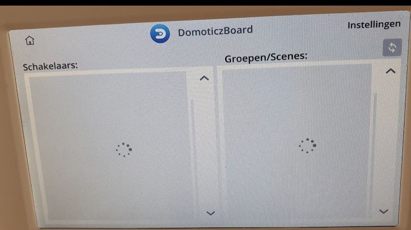

and DomoticzBoard doesn't work anymore.
see pics.
-Internet is working.
-Latest version 5.33.9 is installed, the problem remained.
-Newsapp and Buienradard etc. do work normal.
someone has 'n idea to fix this?

Empty ToonStore can happen when the catalog file cannot be retrieved from github (either because of internet issues at your end or a service interruption at github).
Have you tried to manually refresh the ToonStore catalog (refresh button next to the Instellingen button)?

problem is there for roughly a week now.
Refresh button no luck (internet is avaiable and working on other apps.

can you try the following command at the prompt on Toon:
curl "https://raw.githubusercontent.com/ToonSoftwareCollective/toonstore_AppRepository/master/ToonRepo.xml"
This should return the XML file with the ToonStore apps.

Did you try a reboot?

Should work now. The xml list file for toonstore had an error after a new version for the PostNL app was added yesterday.

TheHogNL wrote:Should work now. The xml list file for toonstore had an error after a new version for the PostNL app was added yesterday.
yup thx, ToonStore is up n running again.
DomoticzBoard...no luck yet...but that's another issue
