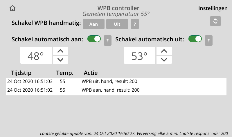

The tile shows the WPB temperature and the status off the last command. When clicking on the Tile you get a screen:
Here you can:
- go to the settings
- refresh the WPB temperature
- manual switch on the WPB
- manual switch off the WPB
- enable/disable automatic switch on WPB when WPB temperature is below a specific temperature
- enable/disable automatic switch off WPB when WPB temperature has reached a specific temperature
(last 2 only visible when WPB controller is enabled)
The screens shows also the status (time, temperature and action) of the last few actions performed. Remember: it shows the action taken and not the current status of the WPB.
There is also a refresh button to get the WPB temperature on request.
There must be a difference of 5 degrees between the adjustable automatic on and off temperature.
Automatic switching WPB off will only occur when the WPB temperature has been 2 degrees or lower below the configured WPB off temperature.
Automatic switching WPB on will only occur when the WPB temperature has been above the configured WPB on temperature.
The settings and rules will become active after leaving the screen!
