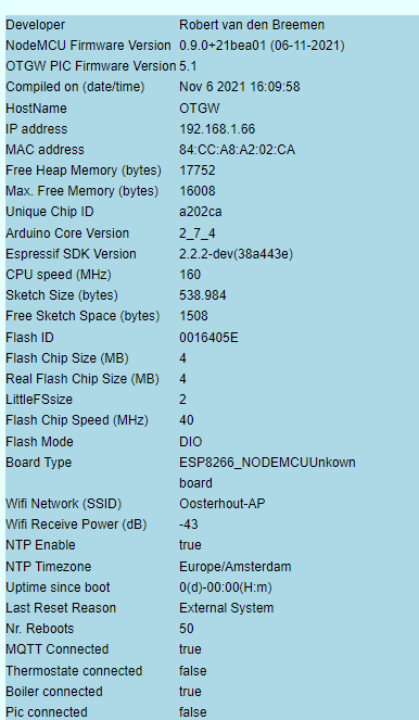

When I log into that webinterface, it shows that the PIC is not connected, but the boiler is, please see the atachment. I disabled MQTT for now, so homeassistant is not doing anything anymore.

Based on the information from the webui you provided and the fact that you use my firmware for the Home Assistant integration I can explain some things you. To enable the Home Assistant integration it needs to know if the OTGW is online or offline. To enable that the ESP8266 monitors the OpenTherm messages if it does not see a message from the Boiler or Thermostat for more than 30 seconds. It will report the connection to be offline. For the purpose of the Home Assistant integration if either connection is offline, then it report the PIC / OTGW as offline. This is why there are three values in the webui too.
I fully agree with Schelte that it's best when troubleshooting to step back and make it work with the least amount of options at first. As you seem to use the latest version of the PCB, version 2.3, I would suggest you connect your OTGW using an USB cable to your PC/Mac and then use the OTmonitor application on the serial port. You can even leave out the wemos D1 at this point.
This is the setup with the least components, that way you can make sure that your boiler and thermostat can communicate with the OTGW inbetween. If that does not work correctly, then follow the troubleshoot guide first.
